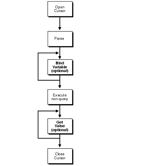

Bind variables allow you to use the same SQL statement multiple times with different values, reducing the number of times a SQL statement needs to be parsed. For example, when you need to insert four rows in a particular table, you can parse the SQL statement once and bind and execute the SQL statement for each row. One SQL statement can have zero or more bind variables.
To execute pass-through SQL statements with bind variables, you must:
Figure 9-1 shows the flow diagram for executing non-queries with bind variables.
The syntax of the non-Oracle system determines how a statement specifies a bind variable. For example, in Oracle you define bind variables with a preceding colon, as in:
UPDATE EMP SET SAL=SAL*1.1 WHERE ENAME=:ename
In this statement :ename is the bind variable. In other non-Oracle systems you may need to specify bind variables with a question mark, as in:
UPDATE EMP SET SAL=SAL*1.1 WHERE ENAME= ?
In the bind variable step, you must positionally associate host program variables (in this case, PL/SQL) with each of these bind variables.
For example, to execute the above statement, you can use the following PL/SQL program:
DECLARE c INTEGER; nr INTEGER; BEGIN c := DBMS_HS_PASSTHROUGH.OPEN_CURSOR@SalesDB; DBMS_HS_PASSTHROUGH.PARSE@SalesDB(c, 'UPDATE EMP SET SAL=SAL*1.1 WHERE ENAME=?'); DBMS_HS_PASSTHROUGH.BIND_VARIABLE(c,1,'JONES'); nr:=DBMS_HS_PASSTHROUGH.EXECUTE_NON_QUERY@SalesDB(c); DBMS_OUTPUT.PUT_LINE(nr||' rows updated'); DBMS_HS_PASSTHROUGH.CLOSE_CURSOR@salesDB(c); END;
In some cases, the non-Oracle system can also support OUT bind variables. With OUT bind variables, the value of the bind variable is not known until after the execution of the SQL statement.
Although OUT bind variables are populated after the SQL statement is executed, the non-Oracle system must know that the particular bind variable is an OUT bind variable before the SQL statement is executed. You must use the BIND_OUT_VARIABLE procedure to specify that the bind variable is an OUT bind variable.
After the SQL statement is executed, you can retrieve the value of the OUT bind variable using the GET_VALUE procedure.
A bind variable can be both an IN and an OUT variable. This means that the value of the bind variable must be known before the SQL statement is executed but can be changed after the SQL statement is executed.
For IN OUT bind variables, you must use the BIND_INOUT_VARIABLE procedure to provide a value before the SQL statement is executed. After the SQL statement is executed, you must use the GET_VALUE procedure to retrieve the new value of the bind variable.

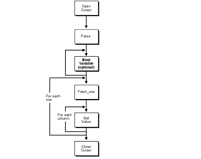

The difference between queries and non-queries is that queries retrieve a result set from a SELECT statement. The result set is retrieved by iterating over a cursor.
Figure 9-2 illustrates the steps in a pass-through SQL query. After the system parses the SELECT statement, each row of the result set can be fetched with the FETCH_ROW procedure. After the row is fetched, use the GET_VALUE procedure to retrieve the select list items into program variables. After all rows are fetched you can close the cursor.
You do not have to fetch all the rows. You can close the cursor at any time after opening the cursor, for example, after fetching a few rows.
The next example executes a query:
DECLARE val VARCHAR2(100); c INTEGER; nr INTEGER; BEGIN c := DBMS_HS_PASSTHROUGH.OPEN_CURSOR@SalesDB; DBMS_HS_PASSTHROUGH.PARSE@SalesDB(c, 'select ename from emp where deptno=10'); LOOP nr := DBMS_HS_PASSTHROUGH.FETCH_ROW@SalesDB(c); EXIT WHEN nr = 0; DBMS_HS_PASSTHROUGH.GET_VALUE@SalesDB(c, 1, val); DBMS_OUTPUT.PUT_LINE(val); END LOOP; DBMS_HS_PASSTHROUGH.CLOSE_CURSOR@SalesDB(c); END;
After parsing the SELECT statement, the rows are fetched and printed in a loop until the function FETCH_ROW returns the value 0.

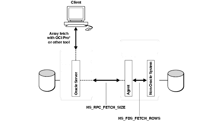

When an application fetches data from a non-Oracle system using Heterogeneous Services, data is transferred:
Oracle allows you to optimize all three data transfers, as illustrated in Figure 9-3.
You can optimize data transfers between your application and the Oracle8i server by using array fetches. See your application development tool documentation for information about array fetching and how to specify the amount of data to be sent per network round trip.
When Oracle retrieves data from a non-Oracle system, the HS initialization parameter HS_RPC_FETCH_SIZE defines the number of bytes sent per fetch between the agent and the Oracle8i server. The agent fetches data from the non-Oracle system until one of the following occurs:
The initialization parameter HS_FDS_FETCH_ROWS determines the number of rows to be retrieved from a non-Oracle system. Note that the array fetch must be supported by the agent. See your agent-specific documentation to ensure that your agent supports array fetching.
By default, an agent fetches data from the non-Oracle system until it has enough data retrieved to send back to the server. That is, it keeps going until the number of bytes fetched from the non-Oracle system is equal to or higher than the value of HS_RPC_FETCH_SIZE. In other words, the agent reblocks the data between the agent and the Oracle database server in sizes defined by the value of HS_RPC_FETCH_SIZE.
When the non-Oracle system supports array fetches, you can immediately send the data fetched from the non-Oracle system by the array fetch to the Oracle database server without waiting until the exact value of HS_RPC_FETCH_SIZE is reached. That is, you can stream the data from the non-Oracle system to the Oracle database server and disable reblocking by setting the value of initialization parameter HS_RPC_FETCH_REBLOCKING to OFF.
For example, assume that you set HS_RPC_FETCH_SIZE to 64K and HS_FDS_FETCH_ROWS to 100 rows. Assume that each row is approximately 600 bytes in size, so that the 100 rows are approximately 60K. When HS_RPC_FETCH_REBLOCKING is set to ON, the agent starts fetching 100 rows from the non-Oracle system.
Because there is only 60K bytes of data in the agent, the agent does not send the data back to the Oracle database server. Instead, the agent fetches the next 100 rows from the non-Oracle system. Because there is now 120K of data in the agent, the first 64K can be sent back to the Oracle database server.
Now there is 56K of data left in the agent. The agent fetches another 100 rows from the non-Oracle system before sending the next 64K of data to the Oracle database server. By setting the initialization parameter HS_RPC_FETCH_REBLOCKING to OFF, the first 100 rows are immediately sent back to the Oracle8i server.
