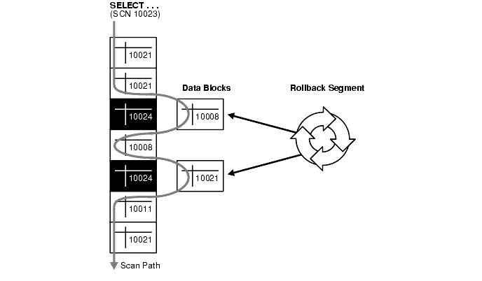

Oracle automatically provides read consistency to a query so that all the data that the query sees comes from a single point in time (statement-level read consistency). Oracle can also provide read consistency to all of the queries in a transaction (transaction-level read consistency).
Oracle uses the information maintained in its rollback segments to provide these consistent views. The rollback segments contain the old values of data that have been changed by uncommitted or recently committed transactions. Figure 24-1 shows how Oracle provides statement-level read consistency using data in rollback segments.
Figure 24-1 Transactions and Read Consistency
As a query enters the execution stage, the current system change number (SCN) is determined; in Figure 24-1, this system change number is 10023. As data blocks are read on behalf of the query, only blocks written with the observed SCN are used. Blocks with changed data (more recent SCNs) are reconstructed from data in the rollback segments, and the reconstructed data is returned for the query. Therefore, each query returns all committed data with respect to the SCN recorded at the time that query execution began. Changes of other transactions that occur during a query's execution are not observed, guaranteeing that consistent data is returned for each query.

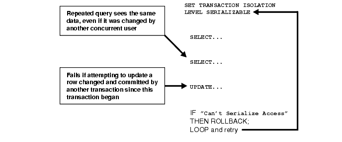

Oracle generates an error when a serializable transaction tries to update or delete data modified by a transaction that commits after the serializable transaction began:
ORA-08177: Cannot serialize access for this transaction
When a serializable transaction fails with the "Cannot serialize access" error, the application can take any of several actions:
Figure 24-2 shows an example of an application that rolls back and retries the transaction after it fails with the "Cannot serialize access" error:
Figure 24-2 Serializable Transaction Failure

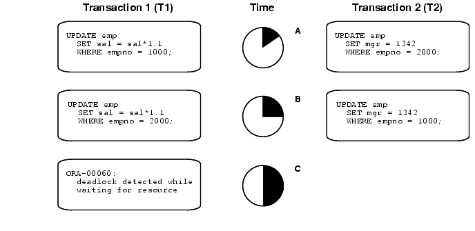

Deadlocks
A deadlock can occur when two or more users are waiting for data locked by each other. Deadlocks prevent some transactions from continuing to work. Figure 24-3 illustrates two transactions in a deadlock.
In Figure 24-3, no problem exists at time point A, as each transaction has a row lock on the row it attempts to update. Each transaction proceeds without being terminated. However, each tries next to update the row currently held by the other transaction. Therefore, a deadlock results at time point B, because neither transaction can obtain the resource it needs to proceed or terminate. It is a deadlock because no matter how long each transaction waits, the conflicting locks are held.
Figure 24-3 Two Transactions in a Deadlock
Deadlock Detection
Oracle automatically detects deadlock situations and resolves them by rolling back one of the statements involved in the deadlock, thereby releasing one set of the conflicting row locks. A corresponding message also is returned to the transaction that undergoes statement-level rollback. The statement rolled back is the one belonging to the transaction that detects the deadlock. Usually, the signalled transaction should be rolled back explicitly, but it can retry the rolled-back statement after waiting.
In distributed transactions, local deadlocks are detected by analyzing a "waits for" graph, and global deadlocks are detected by a time-out. Once detected, nondistributed and distributed deadlocks are handled by the database and application in the same way.
Deadlocks most often occur when transactions explicitly override the default locking of Oracle. Because Oracle itself does no lock escalation and does not use read locks for queries, but does use row-level locking (rather than page-level locking), deadlocks occur infrequently in Oracle.
See Also:
"Explicit (Manual) Data Locking" for more information about manually acquiring locks and for an example of a deadlock situation
Avoiding Deadlocks
Multitable deadlocks can usually be avoided if transactions accessing the same tables lock those tables in the same order, either through implicit or explicit locks. For example, all application developers might follow the rule that when both a master and detail table are updated, the master table is locked first and then the detail table. If such rules are properly designed and then followed in all applications, deadlocks are very unlikely to occur.
When you know you will require a sequence of locks for one transaction, you should consider acquiring the most exclusive (least compatible) lock first.
