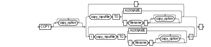

Purpose
Create an image copy of a file. The output file is always written to disk. You can copy the following types of files:
In many cases, copying datafiles is more beneficial than backing them up, since the output is suitable for use without any additional processing. In contrast, you must process a backup set with a restore command before it is usable. So, you can perform media recovery on a datafile copy, but not directly on a backup set, even if it backs up only one datafile and contains a single backup piece.

copy_option
specifies optional parameters affecting either the input or output files or both.

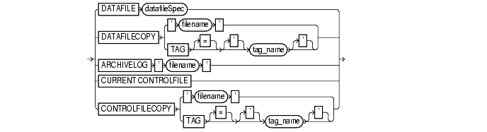

copy_inputfile clause
specifies the type of input file, that is, the file that you want to copy.
datafile datafileSpec
specifies a list of one or more datafiles as input. See "datafileSpec".
Note: If you specify a filename, then it must be the name of a current datafile as listed in the control file.
datafilecopy
specifies a list of one or more datafile copies as input. Specify the datafile copies by 'filename' or tag = tag_name. The filename must not be the name of a current datafile listed in the control file. The existing copy may have been created by either a previous copy command or by an external operating system utility.
archivelog 'filename'
specifies the filename of an input archived redo log. The archived log may have been created by the Oracle archiving session or by a previous copy command. Specify the archived redo log by filename.
current controlfile
specifies the current control file.
controlfilecopy 'filename'
specifies the filename of a control file copy. You can also set tag = tag_name to specify a list of one or more control file copies.
Note: The control file copy is marked as a backup control file, so media recovery will be necessary if you mount the control file copy. This command is equivalent to the ALTER DATABASE BACKUP CONTROLFILE TO '...' statement.
to 'filename'
specifies the filename of the output file copy.
to auxname
specifies that Oracle should copy the input datafile to the filename specified in an earlier set auxname command for the input datafile.
