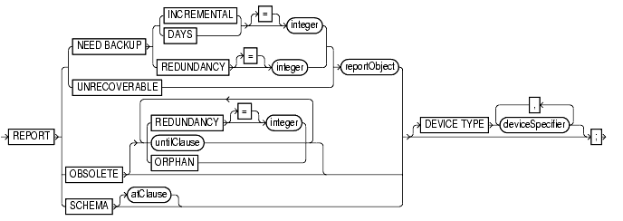

report
Syntax
atClause::=
reportObject::=
Purpose
To perform detailed analyses of the RMAN repository. Oracle writes the output from the report command to standard output or the message log file (see "connect").
Use the report command to answer questions such as the following:
Requirements
Keywords and Parameters
need backup
lists all datafiles in need of a new backup. The report assumes that you will use the most recent backup for restore operations.
incremental integer
specifies a threshold number of incremental backups. If complete recovery of a datafile requires more than the specified number of incremental backups, then the datafile requires a new full backup. The report command, like the recover command, uses the lowest level of incremental backup whenever there is a choice. This is the same strategy that RMAN would use if the file were actually being recovered by the recover command.
Note: Files for which no backups exist will not appear in this list: issue the report need backup redundancy command to display them.
days integer
specifies a threshold number of days of redo log files that need application during recovery of this file. For example, report need backup days 7 database shows the datafiles whose recovery requires more than one week's worth of archived redo logs.
If the target database control file is mounted and current, RMAN makes the following optimizations to this report:
  • Files that are offline and whose most recent backup contains all changes to the file will not be included.
  • Files that were offline and are now online, and whose most recent backup contains all changes up to the offline time, will only be reported if they have been online for more than the specified number of days.
redundancy integer
specifies the minimum number of backups or copies that must exist for a datafile to be considered not in need of a backup. In other words, a datafile needs a backup if there are fewer than integer backups or copies of this file. For example, redundancy 2 means that if there are fewer than two copies or backups of a datafile, then it needs a new backup.
unrecoverable
lists all unrecoverable datafiles. A datafile is considered unrecoverable if an unrecoverable operation has been performed against an object residing in the datafile since the last backup of the datafile.
Note: The non-existence of any backup of a datafile is not sufficient reason to consider it unrecoverable. Such datafiles can be recovered through the use of the CREATE DATAFILE command, provided that redo logs starting from when the file was created still exist.

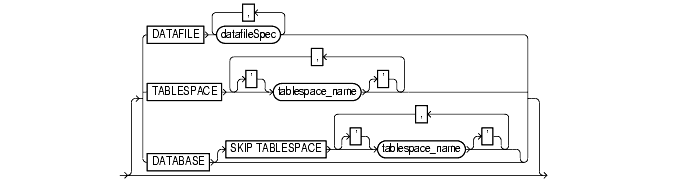

reportObject clause
specifies the datafiles to be included in the report. The report can include the entire database (optionally skipping certain tablespaces), a list of tablespaces, or a list of datafiles.
datafile datafileSpec
lists the specified datafiles. RMAN reports on backups or datafile copies that contain at least one of the specified datafiles.
tablespace tablespace_name
lists datafiles in the specified tablespace. RMAN reports on backups or datafile copies that include at least one datafile from a specified tablespace.
database
lists backups or datafile copies of all files in the current database.
skip tablespace tablespace_name
excludes the specified tablespaces from the database specification.
obsolete
lists full backups and datafile copies recorded in the RMAN repository that can be deleted because they are no longer needed. If you do not specify further parameters, redundancy defaults to 1. If you use this option in conjunction with device type, RMAN only considers backups and copies on the specified type.
redundancy integer
specifies the minimum level of redundancy considered necessary for a backup or copy to be obsolete. A datafile copy is obsolete if there are at least integer more recent backups or image copies of this file; a datafile backup set is obsolete if there are at least integer more recent backups or image copies of each file contained in the backup set. For example, redundancy 2 means that there must be at least two more recent backups or copies of a datafile for any other backup or copy to be obsolete.
untilClause
specifies that no backup or copy will be considered obsolete if there are at least n (where n is the value for redundancy) backups or copies that are more recent but do not contain changes later than the specified time, SCN, or log sequence number. For example, obsolete redundancy 2 until 'SYSDATE-7' means that a backup or copy is obsolete if there are at least two backups or copies that are more recent and those copies were checkpointed more than a week ago.
This clause is useful if the database must be recoverable to non-current time, SCN, or log sequence number. See "untilClause".
orphan
specifies as obsolete those backups and copies that are unusable because they belong to incarnations of the database that are not direct ancestors of the current incarnation. Note that report obsolete orphan displays orphaned backups in addition to the normal display of obsolete backups. For an explanation of orphaned backups, see "Reporting on Orphaned Backups".
schema
lists the names of all datafiles and tablespaces at the specified point in time.

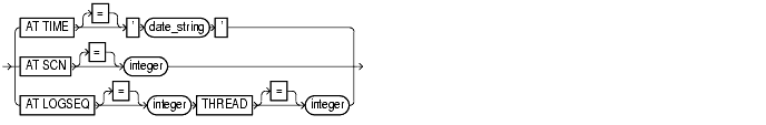

atClause
specifies a point in time as a time, an SCN, or a log sequence number.
at time date_string
specifies a date. The NLS_LANG and NLS_DATE_FORMAT environment variables specify the format for the time.
at scn integer
specifies an SCN.
at logseq integer
specifies a log sequence number for a specified redo thread. The integer indicates the time when the specified log and thread were first opened.
device type deviceSpecifier
specifies the type of storage device. RMAN only considers backups and copies available on the specified device for its report. See "deviceSpecifier".
