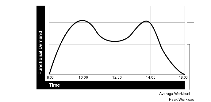

Workload is an important factor when evaluating your system's level of CPU utilization. During peak workload hours, 90% CPU utilization with 10% idle and waiting time may be acceptable. Even 30% utilization at a time of low workload may be understandable. However, if your system shows high utilization at normal workload, then there is no room for a peak workload. For example, Figure 18-1 illustrates workload over time for an application having peak periods at 10:00 AM and 2:00 PM.
This example application has 100 users working 8 hours a day, for a total of 800 hours per day. Each user entering one transaction every 5 minutes translates into 9,600 transactions daily. Over an 8-hour period, the system must support 1,200 transactions per hour, which is an average of 20 transactions per minute. If the demand rate were constant, then you could build a system to meet this average workload.
However, usage patterns are not constant--and in this context, 20 transactions per minute can be understood as merely a minimum requirement. If the peak rate you need to achieve is 120 transactions per minute, then you must configure a system that can support this peak workload.
For this example, assume that at peak workload, Oracle uses 90% of the CPU resource. For a period of average workload, then, Oracle uses no more than about 15% of the available CPU resource, as illustrated in the following equation:
20 tpm/120 tpm * 90% = 15%
Where tpm is transactions per minute.
If the system requires 50% of the CPU resource to achieve 20 tpm, then a problem exists: the system cannot achieve 120 transactions per minute using 90% of the CPU. However, if you tuned this system so that it achieves 20 tpm using only 15% of the CPU, then, assuming linear scalability, the system might achieve 120 transactions per minute using 90% of the CPU resources.
As users are added to an application, the workload can rise to what had previously been peak levels. No further CPU capacity is then available for the new peak rate, which is actually higher than the previous.

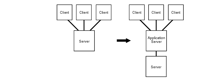

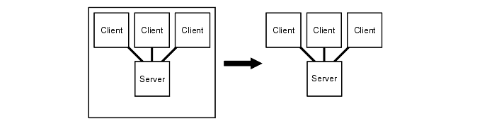

If you have maximized the CPU power on your system and have exhausted all means of tuning your system's CPU use, then consider redesigning your system on another architecture. Moving to a different architecture might improve CPU use. This section describes architectures you could consider using. This section contains the following possibilities:
Consider whether changing from several clients with one server, all running on a single machine (single tier), to a two-tier client/server configuration would relieve CPU problems.
Consider whether using smaller clients improves CPU usage rather than using multiple clients on larger machines. This strategy may be helpful with either two-tier or three-tier configurations.

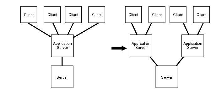

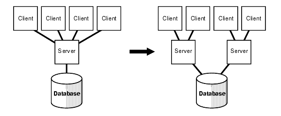

If your system runs with multiple layers, then consider whether moving from a two-tier to three-tier configuration and introducing an application server or a transaction processing monitor might be a good solution.
Consider using one or more application servers or multiple transaction processing monitors.
