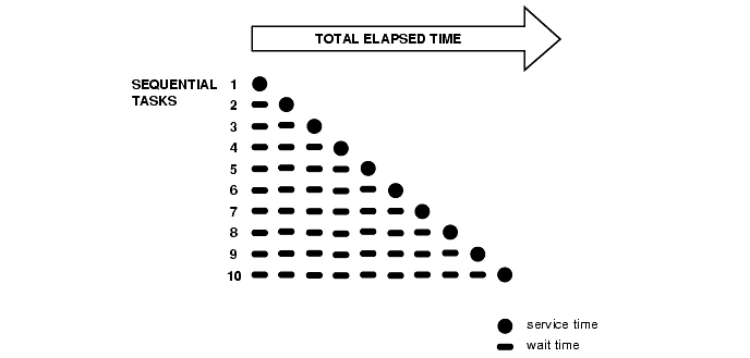

Figure 1-1 illustrates ten independent tasks competing for a single resource.
In this example, only task 1 runs without having to wait. Task 2 must wait until task 1 has completed; task 3 must wait until tasks 1 and 2 have completed, and so on. (Although the figure shows the independent tasks as the same size, the size of the tasks vary.)

The service time for a task may stay the same, but wait time increases as contention increases. If many users are waiting for a service that takes 1 second, then the tenth user must wait 9 seconds for a service that takes 1 second.

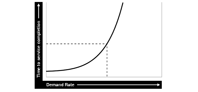

Figure 1-3 shows that as the number of units requested rises, the time to service completion rises.

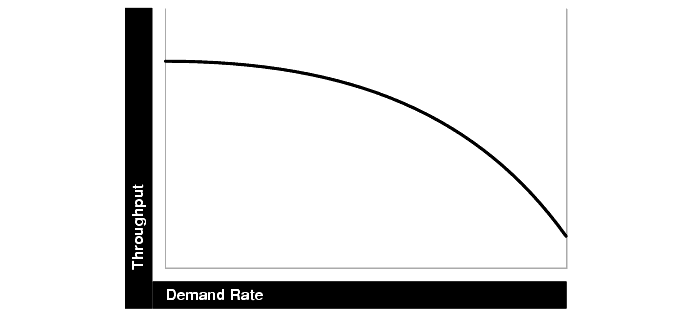

To manage this situation, you have two options:
Excessive demand gives rise to the following:
If there is any possibility of demand rate exceeding achievable throughput, then a demand limiter is essential.

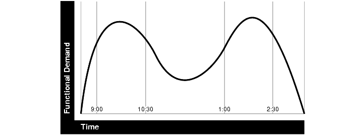

You can relieve performance problems by making the following adjustments:
For example, if your system's busiest times are from 9:00AM to 10:30AM and from 1:00PM to 2:30PM, then you can run batch jobs in the background after 2:30PM when there is more capacity. Thus, you can spread the demand more evenly. Alternatively, you can allow for delays at peak times.
