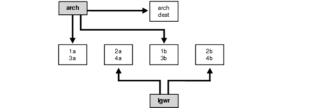

In order to prevent I/O contention between the archiver process and LGWR (when using multi-membered groups), make sure that archiver reads and LGWR writes are separated. For example, if your system has 4 groups with 2 members, then the following scenario should used to separate disk access:
4 groups x 2 members each = 8 logfiles labeled: 1a, 1b, 2a, 2b, 3a, 3b, 4a, 4b.
This requires at least 4 disks, plus one disk for archived files.
Figure 20-2 illustrates how redo members should be distributed across disks to minimize contention.
In this example, LGWR switched out of log group 1 (member 1a and 1b) and is now writing to log group2 (2a and 2b). Concurrently, the archiver process is reading from the group 1 and writing to its archive destination. Note how the redo log files are isolated from contention.

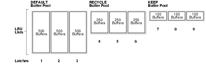

Consider the example in Figure 20-3 where there are 3 DBWn processes and 2 latches for each of the 3 buffer pools, for a total of 6 latches. Each buffer pool would obtain a latch in round robin fashion.
The DEFAULT
buffer pool has 500 buffers for each LRU list. The RECYCLE
buffer pool has 250 buffers for each LRU list. The KEEP
buffer pool has 100 buffers for each LRU.
Thus, the load carried by each of the DBWn processes differs, and performance suffers. If, however, there are 3 latches in each pool, then the DBWn processes have equal loads, and performance is optimized.

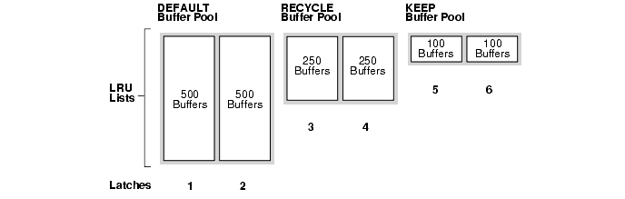

A well-configured system might have 3 DBWn processes and 9 latches, with 3 latches in each buffer pool.
The DEFAULT
buffer pool has 100 buffers for each LRU list.

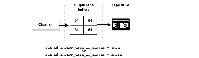

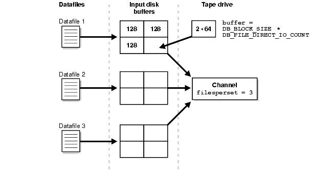

There are two different buffers: disk buffers and tape buffers. They can be different sizes. When RMAN backs up from disk, it allocates four disk buffers for each input datafile. You cannot alter the number of buffers that RMAN allocates.
The size of the disk buffers is controlled by the DB_FILE_DIRECT_IO_COUNT
initialization parameter. This is the number of blocks per buffer. The default is 64.
The size of each buffer is equal to the product of the following initialization parameters:
DB_BLOCK_SIZE * DB_FILE_DIRECT_IO_COUNT
For example, if DB_BLOCK_SIZE
= 2048 and DB_FILE_DIRECT_IO_COUNT
=64, then each disk buffer is 128K. In this example, the total size of the buffers for each datafile is 128K * 4, or 512K. There are 4 buffers allocated for each datafile in the backup set.
If you want to know the total size of the buffers allocated in your backup, then multiply this total by the number of datafiles being accessed by the channel, and then multiply by the number of channels. You should also add a little extra to account for the control structures.
You can reduce the size of the buffers by lowering DB_FILE_DIRECT_IO_COUNT
, but the number of buffers remains at 4 per file.
Oracle allocates 4 buffers per channel for the tape writers (or reads if doing a restore). There are usually 64K each. Therefore, to size this, multiply by 4, and then multiply by the number of channels.
You can change the size of each tape buffer using the parms parameter of the ALLOCATE
CHANNEL
statement. Set blksize to the desired size of each buffer. For example:
allocate channel foo type 'sbt_tape' parms="blksize=16384"
RMAN allocates the tape buffers in the SGA or the PGA. If you set the initialization parameter BACKUP_TAPE_IO_SLAVES
= true
, then RMAN allocates them from the SGA. If you set the parameter to FALSE
, then RMAN allocates the buffers in the PGA.

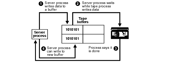

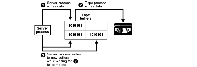

When RMAN reads or writes data, the action is either synchronous or asynchronous. When the I/O is synchronous, a server process can perform only one task at a time. When the I/O is asynchronous, a server process can begin one task, and other processes can perform other tasks while the initial process waits for the task to complete.
You can set initialization parameters that determine the type of I/O. If you set BACKUP_TAPE_IO_SLAVES
to true
, then the I/O is asynchronous. Otherwise, the I/O is synchronous.
Figure 20-7 illustrates synchronous I/O in a backup to tape. The following steps occur:
Figure 20-8 illustrates asynchronous I/O in a backup to tape. The following steps occur:
