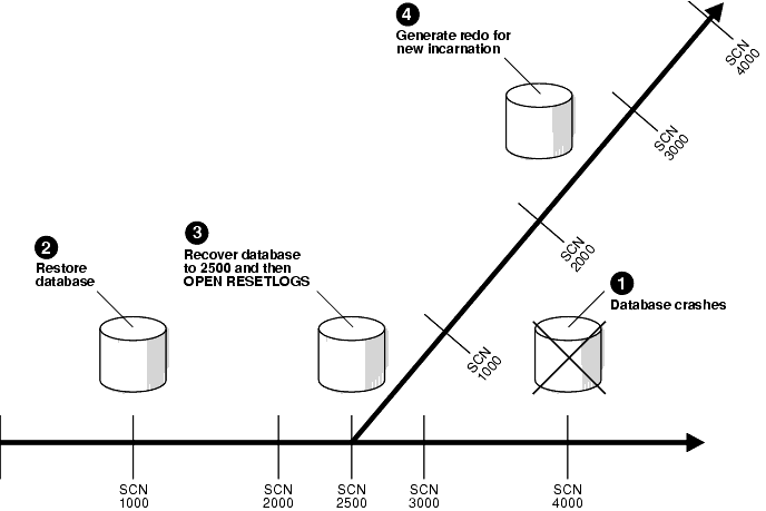

If a database is in NOARCHIVELOG mode and a media failure damages some or all of the datafiles, the only option for recovering the database is usually to restore the most recent whole database backup. If you are using Export to supplement regular backups, then you can instead restore the database by importing an exported backup of the database.
The disadvantage of NOARCHIVELOG mode is that to recover your database from the time of the most recent full backup up to the time of the media failure, you have to re-enter manually all of the changes executed in that interval. If your database was in ARCHIVELOG mode, however, the redo log covering this interval would have been available as archived log files or online log files. Using archived redo logs would have enabled you to use complete or incomplete recovery to reconstruct your database, thereby minimizing the amount of lost work.
If you have a database damaged by media failure and operating in NOARCHIVELOG mode, and you want to restore from your most recent consistent whole database backup (your only option at this point), follow the steps below.
SHUTDOWN ABORT
% cp /oracle/work/BACKUP/tbs* /oracle/dbs # restores datafiles % cp /oracle/work/BACKUP/cf.f /oracle/dbs # restores control file
ALTER DATABASE RECOVER DATABASE UNTIL CANCEL;
ALTER DATABASE OPEN RESETLOGS;
A RESETLOGS operation invalidates all redo in the online logs. Restoring from a whole database backup and then resetting the log discards all changes to the database made from the time the backup was taken to the time of the failure.

Figure 5-1 shows the case of a database that can only be recovered to SCN 2500 because an archived redo log is missing. At SCN 4000, the database crashes. You restore the SCN 1000 backup and prepare for complete recovery. Unfortunately, one of your archived redo logs is corrupted. The log before the missing log contains SCN 2500, so you recover to this point and open with the RESETLOGS option.
As the diagram illustrates, you generate new changes in the new incarnation of the database, eventually reaching SCN 4000. The changes between SCN 2500 and SCN 4000 for the new incarnation of the database are completely different from the changes between SCN 2500 and SCN 4000 for the old incarnation. Oracle does not allow you to apply logs from an old incarnation to the new incarnation. You cannot restore backups from before SCN 2500 in the old incarnation to the new incarnation.
