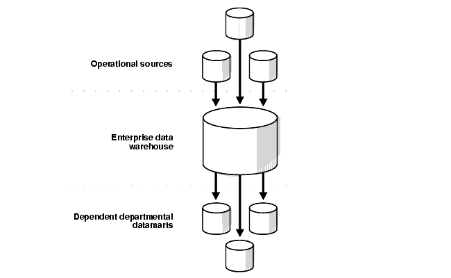

A dependent data mart allows you to unite your organization's data in one data warehouse. This gives you the usual advantages of centralization. Figure 20-1 illustrates a dependent data mart.

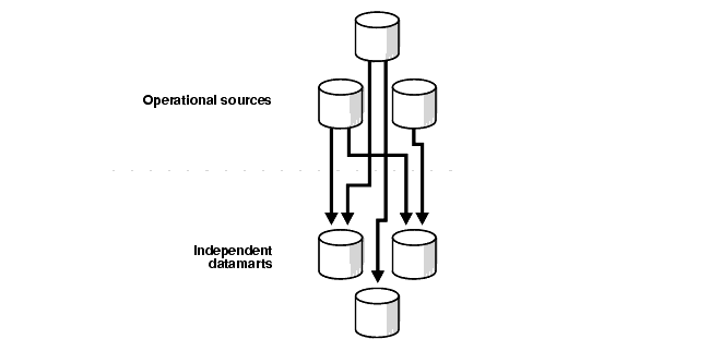

An independent data mart is created without the use of a central data warehouse. This could be desirable for smaller groups within an organization. It is not, however, the focus of this Guide. See the Data Mart Suites documentation for further details regarding this architecture. Figure 20-2 illustrates an independent data mart.

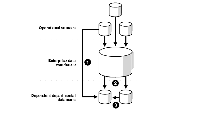

A hybrid data mart allows you to combine input from sources other than a data warehouse. This could be useful for many situations, especially when you need ad hoc integration, such as after a new group or product is added to the organization. Figure 20-3 illustrates a hybrid data mart.
