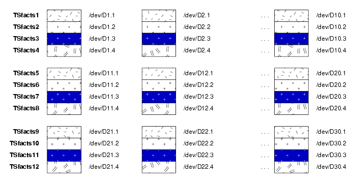

Populating Databases Using Parallel Load
This section presents a case study illustrating how to create, load, index, and analyze a large data warehouse fact table with partitions in a typical star schema. This example uses SQL Loader to explicitly stripe data over 30 disks.
Figure 14-1 Datafile Layout for Parallel Load Example
Step 1: Create the Tablespaces and Add Datafiles in Parallel
Below is the command to create a tablespace named "Tsfacts1". Other tablespaces are created with analogous commands. On a 10-CPU machine, it should be possible to run all 12 CREATE TABLESPACE commands together. Alternatively, it might be better to run them in two batches of 6 (two from each of the three groups of disks).
CREATE TABLESPACE Tsfacts1
DATAFILE /dev/D1.1'  SIZE 1024MB REUSE
DATAFILE /dev/D2.1'  SIZE 1024MB REUSE
DATAFILE /dev/D3.1'  SIZE 1024MB REUSE
DATAFILE /dev/D4.1' SIZE 1024MB REUSE
DATAFILE /dev/D5.1'  SIZE 1024MB REUSE
DATAFILE /dev/D6.1'  SIZE 1024MB REUSE
DATAFILE /dev/D7.1'  SIZE 1024MB REUSE
DATAFILE /dev/D8.1' SIZE 1024MB REUSE
DATAFILE /dev/D9.1'  SIZE 1024MB REUSE
DATAFILE /dev/D10.1  SIZE 1024MB REUSE
DEFAULT STORAGE (INITIAL 100MB NEXT 100MB PCTINCREASE 0)

In Case 3 (illustrated in the example), the DBA wants precise control over the load. To achieve this, the DBA must partition the input data in the same way as the datafiles are partitioned in Oracle.
This example uses 10 processes loading into 30 disks. To accomplish this, the DBA must split the input into 120 files beforehand. The 10 processes will load the first partition in parallel on the first 10 disks, then the second partition in parallel on the second 10 disks, and so on through the 12th partition. The DBA runs the following commands concurrently as background processes:
SQLLDR DATA=jan95.file1.dat DIRECT=TRUE PARALLEL=TRUE FILE=/dev/D1.1
SQLLDR DATA=jan95.file10.dat DIRECT=TRUE PARALLEL=TRUE FILE=/dev/D10.1
WAIT;
SQLLDR DATA=dec95.file1.dat DIRECT=TRUE PARALLEL=TRUE FILE=/dev/D30.4
SQLLDR DATA=dec95.file10.dat DIRECT=TRUE PARALLEL=TRUE FILE=/dev/D29.4

For this approach, all partitions must be in the same tablespace. You need to have the same number of input files as datafiles in the tablespace, but you do not need to partition the input the same way in which the table is partitioned.
For example, if all 30 devices were in the same tablespace, then you would arbitrarily partition your input data into 30 files, then start 30 SQL*Loader sessions in parallel. The statement starting up the first session would be similar to the following:
SQLLDR DATA=file1.dat DIRECT=TRUE PARALLEL=TRUE FILE=/dev/D1
SQLLDR DATA=file30.dat DIRECT=TRUE PARALLEL=TRUE FILE=/dev/D30
The advantage of this approach is that as in Case 3, you have control over the exact placement of datafiles because you use the FILE keyword. However, you are not required to partition the input data by value because Oracle does that for you.
A disadvantage is that this approach requires all the partitions to be in the same tablespace. This minimizes availability.
