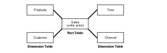

The star schema is the simplest data warehouse schema. It is called a star schema because the diagram of a star schema resembles a star, with points radiating from a center. The center of the star consists of one or more fact tables and the points of the star are the dimension tables.
A star schema is characterized by one or more very large fact tables that contain the primary information in the data warehouse and a number of much smaller dimension tables (or lookup tables), each of which contains information about the entries for a particular attribute in the fact table.
A star query is a join between a fact table and a number of lookup tables. Each lookup table is joined to the fact table using a primary-key to foreign-key join, but the lookup tables are not joined to each other.
Cost-based optimization recognizes star queries and generates efficient execution plans for them. (Star queries are not recognized by rule-based optimization.)
A typical fact table contains keys and measures. For example, a simple fact table might contain the measure Sales, and keys Time, Product, and Market. In this case, there would be corresponding dimension tables for Time, Product, and Market. The Product dimension table, for example, would typically contain information about each product number that appears in the fact table. A measure is typically a numeric or character column, and can be taken from one column in one table or derived from two columns in one table or two columns in more than one table.
A star join is a primary-key to foreign-key join of the dimension tables to a fact table. The fact table normally has a concatenated index on the key columns to facilitate this type of join.
The main advantages of star schemas are that they:
Figure 16-1 presents a graphical representation of a star schema.

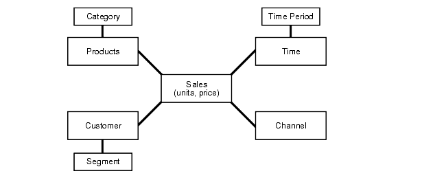

The snowflake schema is a more complex data warehouse model than a star schema, and is a type of star schema. It is called a snowflake schema because the diagram of the schema resembles a snowflake.
Snowflake schemas normalize dimensions to eliminate redundancy. That is, the dimension data has been grouped into multiple tables instead of one large table. For example, a product dimension table in a star schema might be normalized into a Product table, a Product_Category table, and a Product_Manufacturer table in a snowflake schema. While this saves space, it increases the number of dimension tables and requires more foreign key joins. The result is more complex queries and reduced query performance. Figure 16-2 presents a graphical representation of a snowflake schema.
