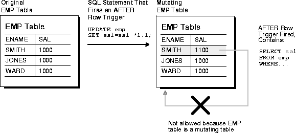

A mutating table is a table that is currently being modified by an UPDATE, DELETE, or INSERT statement, or a table that might need to be updated by the effects of a declarative DELETE CASCADE referential integrity constraint. A constraining table is a table that a triggering statement might need to read either directly, for a SQL statement, or indirectly, for a declarative referential integrity constraint. A table is mutating or constraining only to the session that issued the statement in progress.
Tables are never considered mutating or constraining for statement triggers unless the trigger is fired as the result of a DELETE CASCADE.
For all row triggers, or for statement triggers that were fired as the result of a DELETE CASCADE, there are two important restrictions regarding mutating and constraining tables. These restrictions prevent a trigger from seeing an inconsistent set of data.
PRIMARY, FOREIGN, or UNIQUE KEY columns of a constraining table of the triggering statement.
There is an exception to this restriction; BEFORE ROW and AFTER ROW triggers fired by a single row INSERT to a table do not treat that table as mutating or constraining. Note that INSERT statements that may involve more than one row, such as INSERT INTO emp SELECT . . ., are not considered single row inserts, even if they only result in one row being inserted.
Figure 13-1 illustrates the restriction placed on mutating tables.
Notice that the SQL statement is executed for the first row of the table and then an AFTER ROW trigger is fired. In turn, a statement in the AFTER ROW trigger body attempts to query the original table. However, because the EMP table is mutating, this query is not allowed by Oracle. If attempted, a runtime error occurs, the effects of the trigger body and triggering statement are rolled back, and control is returned to the user or application.
