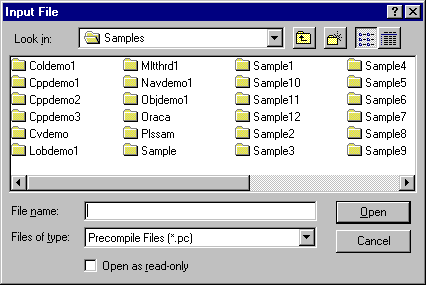

The Input File or Output File dialog box appears.
A Pro*C/C++ project consists of one or more precompilable files.
The selected files appear in the information pane.

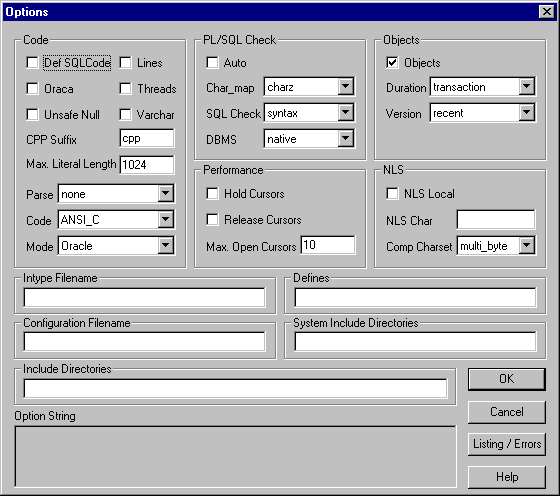

Many useful options are available. They enable you to control how resources are used, how errors are reported, how input and output are formatted, and how cursors are managed.
The Options dialog box appears.

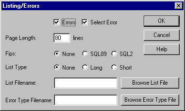

The settings include the type of error information generated and the name of the list file.
See Chapter 9 in the Pro*C/C++ Precompiler Programmer's Guide for a description of the precompiler options. In addition, click the Help button in the Options dialog box for a condensed version of the information in Chapter 9.
See "Using the Precompiler Options" for issues that are related to Pro*C/C++ for Windows NT and Windows 95/98.

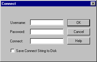

If you selected semantics or full for the SQL Check option in the Options dialog box, you may need to specify database connection information to the Oracle database. You do not need to connect to the Oracle database if every table referenced in a data manipulation statement or PL/SQL block is defined in a DECLARE TABLE statement.

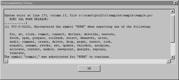

Precompiling can result in success, success with warning(s), or failure. When precompiling is finished, check the Precompilation Status Bar.
Double-click the yellow check or red X to display the Precompilation Status dialog box, which lists warning messages or reasons why the precompilation failed.
Switch to your development environment to fix the problem(s). After you correct the errors, precompile again.

Chapter 9 of the Pro*C/C++ Precompiler Programmer's Guide describes the Pro*C/C++ options. This section highlights issues that are related to Pro*C/C++ for Windows NT and Windows 95/98.
The CODE option has a default setting of ANSI_C. Pro*C/C++ for other operating systems may have a default setting of KR_C.
DBMS=V6_CHAR is deprecated. Use CHAR_MAP=VARCHAR2 with DBMS=V7 instead.
Use the Include Directories field of the Options dialog box to enter INCLUDE path directories. If you want to enter more than one path, separate each path with a semicolon, but do not insert a space after the semicolon. This causes a separate "includes=" string to appear in front of each directory.
For sample programs that precompile with PARSE=PARTIAL or PARSE=FULL, an include path of C:\PROGRAM FILES\DEVSTUDIO\VC\INCLUDE has been added. If Microsoft Visual C++ has been installed at a different location or if Borland C++ is used, modify the Include Directories field accordingly for the sample programs to precompile correctly.
The PARSE option has a default setting of NONE. Pro*C/C++ for other operating systems may have a default setting of FULL.
The VER option is a Windows-specific option.
It takes the first and second most significant digits of the version number of Pro*C/C++ you want to use. This option is an alternative to changing the PROC_DFLT value in the registry.
