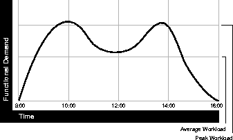

Workload is a very important factor when evaluating your system's level of CPU utilization. During peak workload hours, 90% CPU utilization with 10% idle and waiting time may be understandable and acceptable; 30% utilization at a time of low workload may also be understandable. However, if your system shows high utilization at normal workload, there is no room for peak workload. For example, Figure 13-1 illustrates workload over time for an application which has peak periods at 10:00 AM and 2:00 PM.
Average Workload and Peak WorkloadThis example application has 100 users working 8 hours a day, for a total of 800 hours per day. If each user enters one transaction every 5 minutes, this would mean 9,600 transactions per day. Over the course of 8 hours, the system must support 1,200 transactions per hour, which is an average of 20 transactions per minute. If the demand rate were constant, you could build a system to meet this average workload.
However, usage patterns form peaks and valleys-and in this context 20 transactions per minute can be understood as merely a minimum requirement. If the peak rate you need to achieve is 120 transactions per minute, then you must configure a system that can support this peak workload.
For this example, assume that at peak workload Oracle can use 90% of the CPU resource. For a period of average workload, then, Oracle should be using no more than about 15% of the available CPU resource.
15% = 20 tpm/120 tpm * 90%
If the system requires 50% of the CPU resource to achieve 20 transactions per minute, then it is clear that a problem exists: the system cannot possibly achieve 120 transactions per minute using 90% of the CPU. However, if you could tune this system so that it does achieve 20 transactions per minute using only 15% of the CPU, then (assuming linear scalability) the system might indeed attain 120 transactions per minute using 90% of the CPU resources.
Note that as users are added to an application over time, the average workload can rise to what had previously been peak levels. No further CPU capacity is then available for the new peak rate, which is actually higher than before.

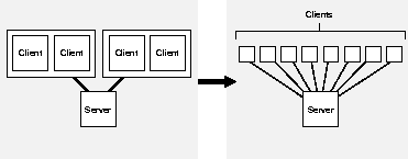

Consider whether changing from clients and server all running on a single machine (single tier) to a two-tier client/server configuration could help to relieve CPU problems.
Consider whether CPU usage might be improved if you used smaller clients, rather than multiple clients on bigger machines. This strategy may be helpful with either two-tier or three-tier configurations.

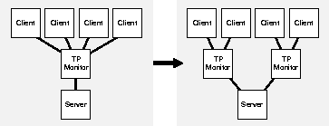

If your system currently runs with multiple layers, consider whether moving from a two-tier to three-tier configuration, introducing the use of a transaction processing monitor, might be a good solution.
Consider whether using multiple transaction processing monitors might be a good solution.
