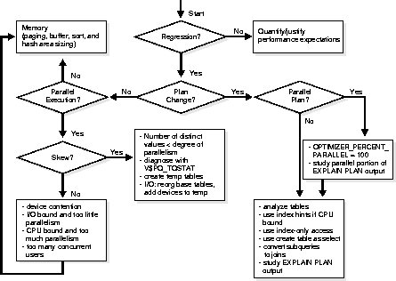

Use the decision tree in Figure 21-1 to diagnose parallel performance problems. Some key issues are the following:
Does parallel execution's actual performance deviate from what you expected? If performance is as you expected, can you justify the notion that there is a performance problem? Perhaps you have a desired outcome in mind, to which you are comparing the current outcome. Perhaps you have a justifiable performance expectation which the system is not achieving. You might have achieved this level of performance or particular execution plan in the past, but now, with a similar environment and operation, this is not being met.
If performance is not as you expected, can you quantify the deviation? For data warehousing operations, the execution plan is key. For critical data warehousing operations, save the EXPLAIN PLAN results. Then, as you analyze the data, reanalyze, upgrade Oracle, and load in new data over the course of time, you can compare any new execution plan with the old plan. You can take this approach either proactively or reactively.
Alternatively, you may find that you get a plan that works better if you use hints. You may want to understand why hints were necessary, and figure out how to get the optimizer to generate the desired plan without the hints. Try increasing the statistical sample size: better statistics may give you a better plan. If you had to use a PARALLEL hint, look to see whether you had OPTIMIZER_PERCENT_PARALLEL set to 100%.
If there has been a change in the execution plan, determine whether the plan is (or should be) parallel or serial.
If the execution plan is (or should be) parallel:
See Also: Parallel EXPLAIN PLAN tags are defined in Table 23-2.
If the execution plan is (or should be) serial, consider the following strategies:
Note: Using different sample sizes can cause the plan to change. Generally, the higher the sample size, the better the plan.
If the cause of regression cannot be traced to problems in the plan, then the problem must be an execution issue. For data warehousing operations, both serial and parallel, consider memory. Check the paging rate and make sure the system is using memory as effectively as possible. Check buffer, sort, and hash area sizing. After you run a query or DML operation, you can look at the V$SESSTAT, V$PQ_SESSTAT and V$PQ_SYSSTAT views to see the number of server processes used, and other information for the session and system.
See Also: "Querying the Dynamic Performance Views: Example" on page 21-12
If parallel execution is occurring, is there unevenness in workload distribution (skew)? For example, if there are 10 CPUs and a single user, you can see whether the workload is evenly distributed across CPUs. This may vary over time, with periods that are more or less I/O intensive, but in general each CPU should have roughly the same amount of activity.
The statistics in V$PQ_TQSTAT show rows produced and consumed per parallel server process. This is a good indication of skew, and does not require single user operation.
Operating system statistics show you the per-processor CPU utilization and per-disk I/O activity. Concurrently running tasks make it harder to see what is going on, however. It can be useful to run in single-user mode and check operating system monitors which show system level CPU and I/O activity.
When workload distribution is unbalanced, a common culprit is the presence of skew in the data. For a hash join, this may be the case if the number of distinct values is less than the degree of parallelism. When joining two tables on a column with only 4 distinct values, you will not get scaling on more than 4. If you have 10 CPUs, 4 of them will be saturated but 6 will be idle. To avoid this problem, change the query: use temporary tables to change the join order such that all operations have more values in the join column than the number of CPUs.
If I/O problems occur you may need to reorganize your data, spreading it over more devices. If parallel execution problems occur, check to be sure you have followed the recommendation to spread data over at least as many devices as CPUs.
If there is no skew in workload distribution, check for the following conditions:
After analyzing your tables and indexes, you should be able to run operations and see speedup that scales linearly with the degree of parallelism used. The following operations should scale:
Start with simple parallel operations. Evaluate total I/O throughput with SELECT COUNT(*) FROM facts. Evaluate total CPU power by adding a complex WHERE clause. I/O imbalance may suggest a better physical database layout. After you understand how simple scans work, add aggregation, joins, and other operations that reflect individual aspects of the overall workload. Look for bottlenecks.
Besides query performance you should also monitor parallel load, parallel index creation, and parallel DML, and look for good utilization of I/O and CPU resources.
Use an EXPLAIN PLAN statement to view the sequential and parallel operation plan. The OTHER_TAG column of the plan table summarizes how each plan step is parallelized, and describes the text of the operation used by parallel server processes for each operation. Optimizer cost information for selected plan steps is given in the COST, BYTES, and CARDINALITY columns. Table 23-2 summarizes the meaning of the OTHER_TAG column.
EXPLAIN PLAN thus provides detailed information as to how specific operations are being performed. You can then change the execution plan for better performance. For example, if many steps are serial (where OTHER_TAG is blank, serial to parallel, or parallel to serial), then the parallel controller could be a bottleneck. Consider the following SQL statement, which summarizes sales data by region:

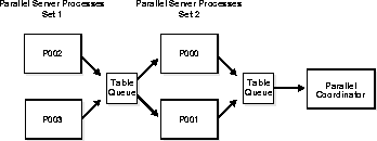

Figure 21-2 illustrates how, with the PARALLEL_TO_PARALLEL keyword, data from the partitioned table is redistributed to a second set of parallel server processes for parallel grouping. Query server set 1 executes the table scan from the preceding example. The rows coming out are repartitioned through the table queue to parallel server set 2, which executes the GROUP BY operation. Because the GROUP BY operation indicates PARALLEL_TO_SERIAL, another table queue collects its results and sends it to the parallel coordinator, and then to the user.
As a rule, if the PARALLEL_TO_PARALLEL keyword exists, there will be two sets of parallel server processes. This means that for grouping, sort merge, or hash joins, twice the number of parallel server processes are assigned to the operation. This requires redistribution of data or rows from set 1 to set 2. If there is no PARALLEL_TO_PARALLEL keyword, then the operation gets just one set of servers. Such serial processes include aggregations, such as COUNT(*) FROM facts or SELECT * FROM facts WHERE DATE = '7/1/94'.
For non-distributed operations, the OBJECT_NODE column gives the name of the table queue. If the PARALLEL_TO_PARALLEL keyword exists, then the EXPLAIN PLAN of the parent operation should have SQL that references the child table queue in its FROM clause. In this way the plan describes the order in which the output from operations is consumed.
