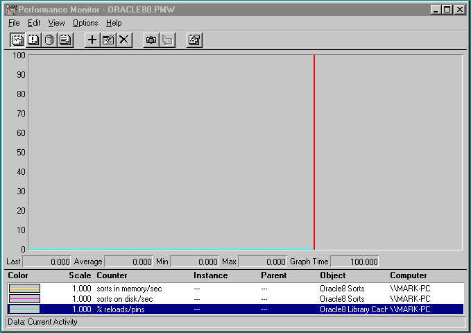

To access Oracle8 Performance Monitor:
Choose Start > Programs > Oracle for Windows NT - [HOME_NAME] > Oracle8 Performance Monitor.
The Performance Monitor window appears with the Chart View:
The Oracle8 Performance Monitor has four views you can choose from the View menu:
For each view (Chart, Alert, Log, and Report), you can decide on the objects you want to monitor and save those settings to a file. When an object is chosen, it is assigned a counter, a color, and added to the status bar at the bottom of Oracle8 Performance Monitor.

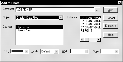

To add objects to a view:
The Add to (Chart, Alert, Log, Report) dialog box appears.
Below is the Add to Chart dialog box. Note the corresponding dialog boxes for the other views are different.
Below are the elements of the Add to Chart dialog box. The other views' dialog boxes have similar features.
The selections you have chosen to monitor are displayed.

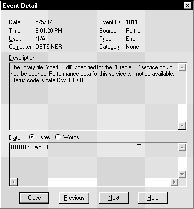

To use the Event Viewer:
The Event Detail dialog box appears with more information about the selected event:
