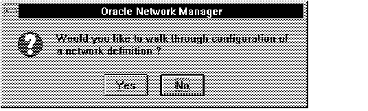

If you have never used Network Manager before, you may want to use the online walk-through. If so, select Yes. The online walk-through is described in the following section.

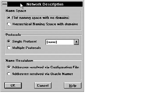

The next window that appears, as shown in Figure 3 - 3, asks about the major characteristics of your network:
Figure 3 - 3. Network Description Window of the Walk-Through
Based on your answers, the appropriate property sheets will be opened for you. Network Manager describes the purpose of each property sheet before it opens. Figure 3 - 4 shows an example:

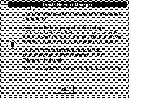

Figure 3 - 4. Walk-Through Explanation of the Community Property Sheet

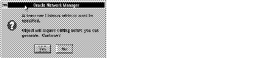

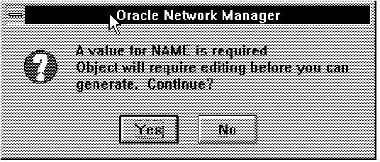

Figure 3 - 5. Walk-Through Reminder of Required Information
Select Yes. You will be prompted to supply the required value. If you do not correct it, you will be asked if you want to stop the walk-through. If you select Yes, the walk-through will disappear.

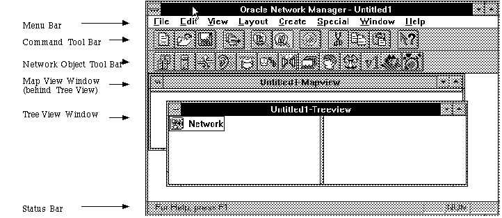

Figure 3 - 6. Network Manager Interface
These parts of Network Manager are described in the following sections.

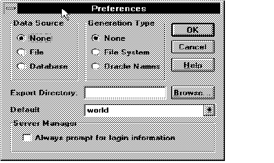

Preferences enables you to speed up the process of building a network definition. This menu item enables you to choose whether you want to save your network definitions to a file system or to a database, and whether you want to generate configuration files for a network that does or does not include Oracle Names. You do not need to use this menu item; if you do not use it, Network Manager asks you to make these choices as you proceed through the network configuration process. When you select this menu item, a pop-up window like that in Figure 3 - 7 appears.
Figure 3 - 7. Preferences Window
Select your choices, as follows:

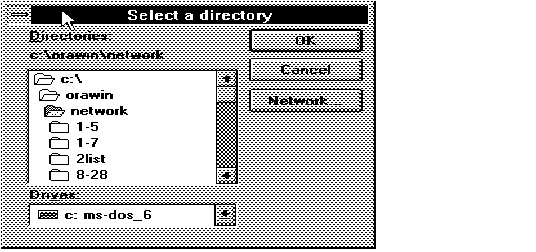

Note: You must select a directory that already exists; the tool cannot create a new directory for you.
When you are satisfied with your responses, select OK to close the Preferences window.

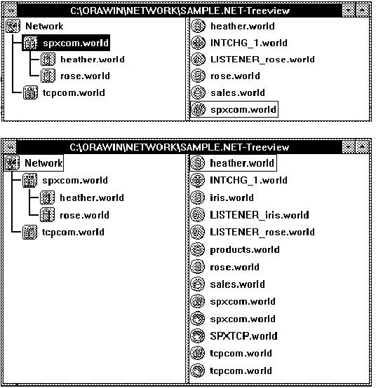

Note that the objects displayed and their organization are determined by whether Community Layout or Domain Layout is selected. The default is Community Layout. In this view, the communities are shown with their nodes below them. In Domain Layout, the local region is shown with its domains and nodes.
Note: If the network you are configuring has only one domain, there is no reason to use the Domain Layout.
The objects that are shown on the right side of the window depend on what object is highlighted on the left. Only the selected component and its dependents are shown. For example, if Network, the top level of the hierarchy, is selected, all components are shown. If a node is selected, only that node and its services are shown. Figure 3 - 8 shows two images of the tree view for a network. In the first image, one community in the network is highlighted (on the left), and therefore only that community and its contents are shown on the right. In the second image, the network, or top level, is highlighted, and therefore all the components of the network are shown.
After you have created a network object, you can open its property sheet to edit it by double-clicking on its icon in the Object List.
Figure 3 - 8. Two Tree Views of a Network

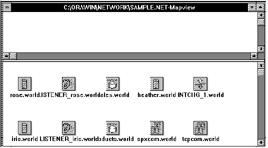

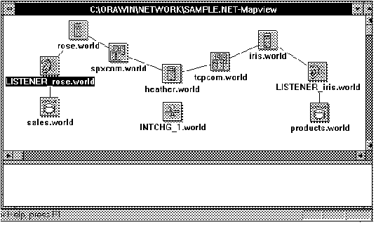

Figure 3 - 9. Map View Window
At any time you can select the icons in this window and move them to the upper part of the window. Lines appear between them showing their relationships, as illustrated in Figure 3 - 10.
Figure 3 - 10. Map View with Network Objects Arranged
Hint: If you drag an icon from the Network Object Tool Bar directly onto a "parent" object in the Map View or in the Object List of the Tree View, its property sheet will open with its location already provided. For example, if you drag a node icon onto a community icon, the node will be assigned to that community. If you drag a listener icon onto a node, its property sheet will have that node selected.

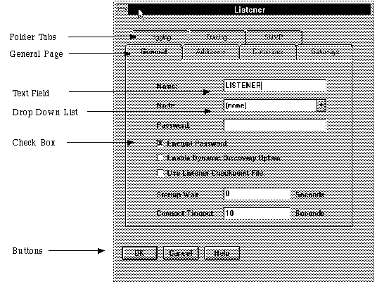

Figure 3 - 11. Property Sheet for a Listener
, "Entering Component Information."
To define other related chunks of information, select one of the other pages by selecting its Folder Tab at the top of the page.
Example
The Listener property sheet has seven pages. When you select Addresses, a page appears that enables you to define the network location of the listener. When you select Databases, you are able to create a database for the listener.
Drop-down List: If a field includes a down arrow, it contains a drop-down list. When you select the arrow, a list of choices appears, from which you can make a selection.
Example
On the Listener property sheet, selecting the arrow in the Node field produces a list of nodes that have been defined in the network. Select the desired object.
List Box: A plain box containing a list is a list box. You cannot enter data directly into a list box, but you can select from the listed items.
Check box: A small button next to a labeled utility that toggles on and off, shown by the presence or absence of an X in the box, is a check box.
Example
On the Listener property sheet, the Encrypt Password feature is toggled on or off with a check box.
Disabled items: (Not shown on Listener window in Figure 3 - 11.) If a field is not applicable in the current context, it is greyed out. You cannot access disabled fields or menu items.

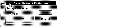

The network definition that is created when you save the completed Network Manager property sheets can be stored in either a file or a database.
b. Create a single node. The node is the node for the Names Server database.
c. Create a listener and a database.
d. Create a Names Server.
Figure 3 - 13. Network Definition Format

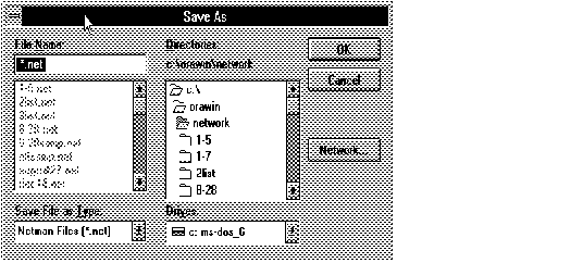

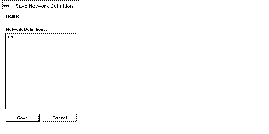

When you have made your choice, select OK. Another pop-up window appears (Figure 3 - 14), showing the Save As screen. Select the directory you want by double-clicking the icon in the right-hand column. You can select the file you want by double clicking on its icon. If you want to create a new file, enter its name in the File Name text box.
Figure 3 - 14. The Save-to Window: Choosing Where to Save
To exit the window without saving, select Cancel.

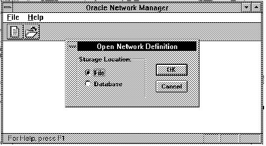

After you have performed this procedure once, subsequent updates can be saved to the same network definition simply by selecting Save on the File menu of the Oracle Network Manager menu bar or from the Tool Bar.

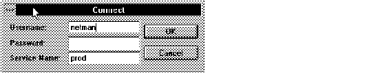

of this Guide. Having done so, you can save to a database by following these steps:
Figure 3 - 15. Connect to Database Window
Figure 3 - 16. Save to Database WindowTo exit the window at any point without saving, select Cancel.
After you go through this procedure the first time, simply select Save on the File menu of the Oracle Network Manager window to save subsequent updates to the same network definition in the database.

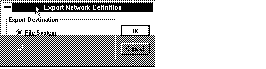

Network Manager asks you if you want to generate to the file system or to Oracle Names and the file system, as shown in Figure 3 - 17. Choose File System unless you are using Oracle Names in your network. With either choice, files are created in a directory with the same name as the name you gave the network. You can select where in the file system you want that directory to be created (see Figure 3 - 18). You will later need to distribute the files from this location to the appropriate directories on nodes and clients throughout the network. Methods for doing this are discussed

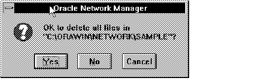

Note: Network Manager can create this new directory for the configuration files. The directory does not have to be created manually first.
When a configuration directory already has files in it, a pop-up message window appears, shown in Figure 3 - 19, asking if you wish to delete all files in the target directory. To avoid old files being mixed with the new, Network Manager deletes the old files before generating the new ones.
Figure 3 - 19. Delete Files Warning
Example
Suppose you have already generated configuration files for the "sales" network, and then you edit the network definition without changing its name. Network Manager will delete all existing files in the "sales" directory before generating new configuration files there, unless you specify a different path so that the new "sales" directory can coexist with the old one.
Attention: Be sure that the configuration directory does not contain valuable subdirectories or files before you select Yes. Once deleted, they cannot be recovered.
If you have files you wish to save in the configuration directory, select No. Then either choose a different path to another configuration directory or move the files you want to save. The Generate process does not continue when you select No.
If you select Yes, Network Manager removes the existing files from the configuration directory and creates new subdirectories and configuration files. Turn to Chapter 6, "Distributing the Configuration Files," to learn how the configuration files are organized and how to distribute them.
