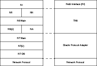

Log files provide information contained in an error stack. An error stack refers to the information that is produced by each layer in an Oracle communications stack as the result of a network error.
Figure 10-1 depicts the relationship among Oracle network products as they might appear in an error stack:
The layers in Figure 8-1 are as follows:
Your network may or may not include all of these components.
