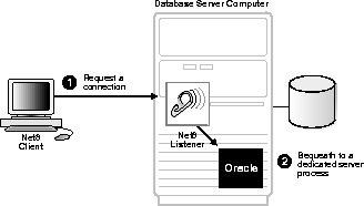

If the listener and server exist on the same node, the listener may create or `spawn' dedicated server processes as connect requests are received. Dedicated server processes are committed to one session only and exist for the duration of that session. The sequence of events that occur when the listener creates a dedicated server process and passes or `bequeaths' control of a session to it is as follows:
When a client disconnects, the dedicated server process associated with the client closes.
Figure 2-2 depicts the role of the network listener in a bequeathed connection to a dedicated server process.

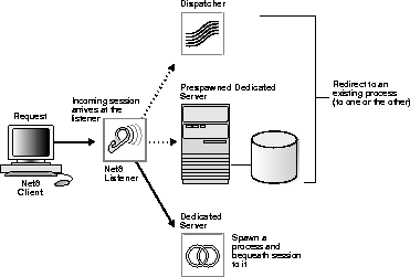

Alternatively, Net8 may redirect the request to an existing server process. It does this by sending the address of an existing server process back to the client. The client will then resend its connect request to the server address provided.
Existing server processes include:
Net8 provides the option of automatically creating dedicated server processes before the request is received. These processes last for the life of the listener, and can be reused by subsequent connection requests. The use of prespawned dedicated server processes requires specification in a listener configuration file.

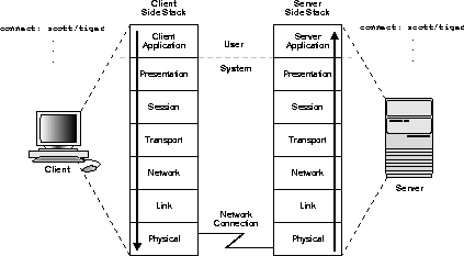

Stack communications can be explained by referencing the Open System Interconnection (OSI) model. In the OSI model, communication between separate computers occurs in a stack-like fashion with information passing from one node to the other through several layers of code. Figure 2-5 depicts a typical OSI Protocol Communications Stack.
Information descends through layers on the client side where it is packaged for transport across a network medium in a manner that it can be translated and understood by corresponding layers on the server side.
A typical OSI protocol communications stack will contain seven such layers:

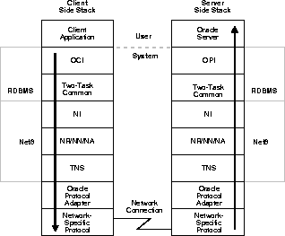

Stack communications allow Oracle clients and servers to share, modify, and manipulate data between themselves. The layers in a typical Oracle communications stack are similar to those of a standard OSI communications stack.
In an Oracle client-server transaction, information passes through the following layers:
Figure 2-6 depicts a typical communications stack in an Oracle networking environment.

Two-Task Common provides character set and data type conversion between different character sets or formats on the client and server. This layer is optimized to perform conversion only when required on a per connection basis.
At the time of initial connection, Two Task Common is responsible for evaluating differences in internal data and character set representations and determining whether conversions are required for the two computers to communicate.
Net8 provides all session layer functionality in an Oracle communications stack. It is responsible for establishing and maintaining the connection between a client application and server, as well as exchanging messages between them. Net8 itself has three component layers that facilitate session layer functionality:
Oracle Protocol Adapters are responsible for mapping TNS functionality to industry-standard protocols used in the client-server connection. Each adapter is responsible for mapping the equivalent functions between TNS and a specific protocol.
