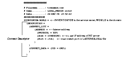

A sample file is shown in Figure C-1:
Figure C-1 TNSNAMES.ORA Configuration File

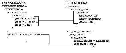

The address of the server in TNSNAMES.ORA is the same as the address of the network listener for a server in LISTENER.ORA. Similarly, the address in the TNSNAMES.ORA file includes the SID which is required (as SID_NAME) in the LISTENER.ORA file. Figure C-2 shows the matching elements:
Figure C-2 TNSNAMES.ORA and LISTENER.ORA

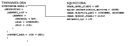

The domain added to the service name in TNSNAMES.ORA is the same as the domain defined in the NAMES.DIRECTORY_PATH parameter in the SQLNET.ORA. Figure C-3 shows the relationship:
Figure C-3 TNSNAMES.ORA and SQLNET.ORA
Please note that the default domain WORLD appended to the service name if the server name does not have the .DOMAIN extension in a connect string. For example, the connect string SCOTT/TIGER@INVENTORYDB gets searched in the TNSNAMES.ORA as INVENTORYDB.WORLD because the SQLNET.ORA has a NAMES.DEFAULT_DOMAIN = WORLD. If the connect string has the DOMAIN extension, (such as SCOTT/TIGER@HR.US), the default domain is not appended.
