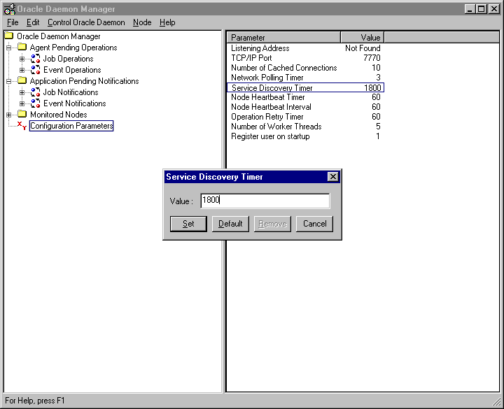

The Oracle Daemon Manager allows you to manage communication between the Console's Communication Daemon and agents. The Daemon Manager Menu provides options for performing administration tasks. The Daemon Manager window provides a tree structure for viewing:
If you launch the Daemon Manager when Oracle Enterprise Manager
is not running, you can only configure the parameter settings.

The Communication Daemon parameters and settings are viewed
and updated with Oracle Daemon Manager. The defaults are usually sufficient
to run Enterprise Manager. See Figure 6-1,
"Parameter Settings for the Communication Daemon" for an illustration
of the daemon parameters.
The parameters for the Communication Daemon include:
The listening address of the daemon. The default (Not Found) is actually:
(ADDRESS=(HOST=console_hostname)(PROTOCL=tcp)(PORT=7770)
If this address is changed, the setting must be a valid TNS
address. If this address is set, the daemon uses this address and the TCP/IP
Port setting is ignored.
The Listening Address parameter should be changed when:
When entering an address, make sure you are using a valid TNS address. For more information on TNS addresses, see the Oracle networking documentation, such as the Net8 Administrator's Guide or the Network Manager Administrator's Guide.
The TCP/IP port on which the daemon listens on. If the Listening Address parameter is not set, the daemon listens using TCP/IP with this port setting. The default is 7770. If an error message displays regarding "failed to listen for incoming requests", you may to need change the default value.
The number of open connections to agents. Default is 5 connections.
The frequency that the daemon checks for incoming data from an agent. Default is 3 seconds. This parameter is not used in this release.
Frequency that the daemon queries for additional services that have been added to the network. Default is 1800 seconds.
Frequency that the daemon checks to see if a node is up. This applies to nodes registered with the UpDown event. Default is 60 seconds.
Frequency that the daemon checks if a node is up after the node has been determined to be up and working. This can be set to a different value than the Node Heartbeat Timer so that a working node is checked at a less frequent interval. Default is 60 seconds.
Frequency that the daemon retries any failed operation. Default is 60 seconds.
The number of threads available. This setting should match the size of the connection cache. Default is 5.
Determines whether the user is registered at the computer where Enterprise Manager is started. If set to 1, the user is registered at the machine where Enterprise Manager is started. If set to 0, the registration is ignored. Default is 1.
Instructs the daemon to use PPP to establish communication
with the Agent when connecting to the network by modem. If set to 0, the
daemon will not use PPP. If set to 1, the daemon will use PPP to connect
to the Agent. The parameter must be set to 1 for both hosts with multiple
homes and machines that use only PPP. If PPP is not available and this
parameter is set to 1, an error message will result when the daemon attempts
to connect. The default value is 0.
The PPP support works only with Windows Socket (WinSock)
version 2.0 and above. If PPP is enabled, you must use the Windows Dial-Up
Networking application when dialing in to the network.
A new parameter setting is used the next time Enterprise
Manager is started. You must have permission to update the NT registry
to change the parameters.
The Daemon Manager menu options allow you to view and manage
event, job, and daemon operations.

The Control Oracle Daemon menu provides the following options:
Forces the daemon to check for the current network objects.
Forces the retry of operations for all nodes. This is useful if the Console machine has been disconnected or if you are dialing into the network at intervals.
Forces the daemon to monitor (heartbeat) the nodes to see
if they are up.
