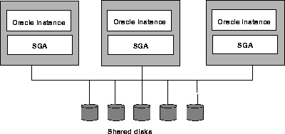

Oracle Parallel Server allows separate Oracle instances to run on different nodes. These instances operate against a common database which resides on shared disks physically accessible by all nodes that make up the cluster. The application database files reside on shared disks. Oracle8 environment files reside on local disks on a node. Each node has an Oracle8 server instance running and simultaneously accesses application data files on shared disks.
Oracle Parallel Server coordinates each node's access to the shared database, assuring data consistency and integrity. It provides complete data and lock recovery support should any node fail for abnormal reasons.
An Oracle instance is defined as the set of processes and resources required for proper database operation. The pool of processes or threads that make up an instance coordinate their work on the database through shared memory by means of the Shared Global Area (SGA). All processes or threads belonging to the instance exist on the same node.
Oracle Parallel Server allows separate instances to coordinate operations on a common database. Typically, only a single instance is run on each node; the Parallel Server option allows multiple instances on separate nodes, each operating against the same database.
The following diagram illustrates how Oracle Parallel Server allows simultaneous access to the database.
