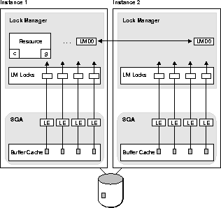

Parallel cache management locks, or PCM locks, are
the instance locks which manage the locking of blocks in datafiles. They
can cover one or more blocks of any class: data blocks, index blocks, undo
blocks, segment headers, and so on. Oracle Parallel Server uses these instance
locks to coordinate access to shared resources. The Integrated DLM maintains
the status of the instance locks.
PCM locks ensure cache coherency by forcing instances to
acquire a lock before modifying or reading any database block. PCM locks
allow only one instance at a time to modify a block. If a block is modified
by an instance, the block must first be written to disk before another
instance can acquire the PCM lock, read the block, and modify it.

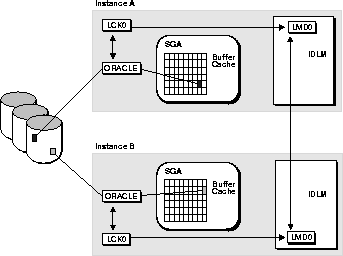

Figure 9-2 illustrates the
way PCM locks work. When instance A reads in the black block for modifications,
it obtains the PCM lock for the black block. The same scenario occurs with
the shaded block and Instance B. If instance B requires the black block,
the block must be written to disk because instance A has modified it. The
ORACLE process communicates with the LMD processes in order to obtain the
instance lock from the IDLM.
Each instance has at least one LCK background process. If
multiple LCK processes exist within the same instance, the PCM locks are
divided among the LCK processes. This means that each LCK process is only
responsible for a subset of the PCM locks.

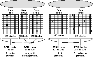

Typically, a PCM lock covers a number of data blocks. The number of PCM locks assigned to datafiles and the number of data blocks in those datafiles determines the number of data blocks covered by a single PCM lock.
If the size of each file, in blocks, is a multiple of the
number of PCM locks assigned to it, then each hashed PCM lock covers exactly
the number of data blocks given by the equation.
If the file size is not a multiple of the number of
PCM locks, then the number of data blocks per hashed PCM lock can vary
by one for that datafile. For example, if you assign 400 PCM locks to a
datafile which contains 2,500 data blocks, then 100 PCM locks cover 7 data
blocks each and 300 PCM locks cover 6 blocks. Any datafiles not specified
in the GC_FILES_TO_LOCKS initialization parameter use the remaining PCM
locks.
If n files share the same hashed PCM locks, then the
number of blocks per lock can vary by as much as n. If you assign
locks to individual files, either with separate clauses of GC_FILES_TO_LOCKS
or by using the keyword EACH, then the number of blocks per lock does not
vary by more than one.
If you assign hashed PCM locks to a set of datafiles collectively,
then each lock usually covers one or more blocks in each file. Exceptions
can occur when you specify contiguous blocks (using the "!blocks"
option) or when a file contains fewer blocks than the number of locks assigned
to the set of files.

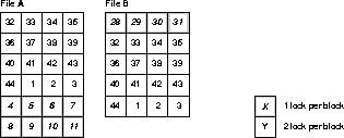

The following example illustrates how hashed PCM locks can
cover multiple blocks in different files. Figure
9-3 assumes 44 PCM locks assigned to 2 files which have a total of
44 blocks. GC_FILES_TO_LOCKS is set to A,B:44
Block 1 of a file does not necessarily begin with lock 1;
a hashing function determines which lock a file begins with. In file A,
which has 24 blocks, block 1 hashes to lock 32. In file B, which has 20
blocks, block 1 hashes to lock 28.
In Figure 9-3, locks 32 through
44 and 1 through 3 are used to cover 2 blocks each. Locks 4 through 11
and 28 through 31 cover 1 block each; and locks 12 through 27 cover no
blocks at all!

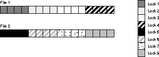

Note also the periodicity of PCM locks. Figure
9-4 shows a file of 30 blocks which is covered by 6 PCM locks. This
file has hashed to begin with lock number 5. As suggested by the shaded
blocks covered by PCM lock number 4, use of each lock forms a pattern over
the blocks of the file.

In fine grain locking, the name of the lock element is the
name of the resource inside the IDLM.
Although a fixed number of lock elements cover potentially
millions of blocks, the lock element names change over and over again as
they are associated with specific blocks that are requested. The lock element
name (for example, LE7,1) contains the database block address (7) and class
(1) of the block it covers. Before a lock element can be reused, the IDLM
lock must be released. You can then rename and reuse the lock element,
creating a new resource in the IDLM if necessary.
When using fine grain locking, you can set your system with
many more potential lock names, since they do not need to be held concurrently.
However, the number of blocks mapped to each lock is configurable in the
same way as hashed locking.
In fine grain locking you can set a one-to-one relationship
between lock elements and blocks. Such an arrangement, illustrated in Figure
9-8, is called DBA locking. Thus if LE2,1 is pinged, only block
DBA2 is written to disk.

Figure 9-9 shows how fine
grain locking operates.
The foreground process checks in the SGA to see if the instance owns a lock on the block.

Figure 9-10 shows an example
of mapping blocks to PCM locks for the parameter value GC_FILES_TO_LOCKS
= "1=60:2-3=40:4=140:5=30".
In datafile 1 of the figure, 60 PCM locks map to 120 blocks,
which is a multiple of 60. Each PCM lock therefore covers two data blocks.
In datafiles 2 and 3, 40 PCM locks map to a total of 160
blocks. A PCM lock can cover either one or two data blocks in datafile
2, and two or three data blocks in datafile 3. Thus, one PCM lock may cover
three, four, or five data blocks across both datafiles.
In datafile 4, each PCM lock maps exactly to a single data
block, since there is the same number of PCM locks as data blocks.
In datafile 5, 30 PCM locks map to 170 blocks, which is not
a multiple of 30. Each PCM lock therefore covers five or six data blocks.

Examples 5, 6, and 7 show the results of specifying various
values of GC_FILES_TO_LOCKS. In the examples, files 1 and 2 each have 16
blocks of data.
In this example four locks are specified for files 1 and
2. Therefore, the number of blocks covered by each lock is 8 ((16+16)/4).
The blocks are not contiguous.
2. However, the locks must cover 8 contiguous blocks.
GC_FILES_TO_LOCKS="1-2=4!4EACH"
In this example four locks are specified for file 1 and four
for file 2. The locks must cover 4 contiguous blocks.
The following example shows fine grain locking mixed with
hashed locking.
File 1 has hashed PCM locking with 4 locks. On file 2, fine
grain locks are allocated on demand-none are initially allocated.
