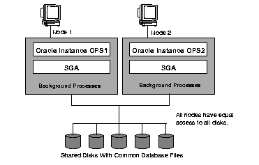

Oracle Parallel Server allows multiple instances to coordinate data manipulation operations on a common database. An Oracle Parallel Server instance is defined as a process and a set of threads and memory structures required for proper database operation. The pool of threads that make up an instance coordinate their work on the database through shared memory by means of the instance Shared Global Area (SGA). Users can connect to any instance to access the information that resides within the shared database.
The database files are located on disk drives that are shared between the multiple nodes. If one node fails, client applications (written to do so) can re-route users to another node. One of the surviving nodes automatically performs recovery by rolling back any incomplete transactions that the other node was attempting. This ensures the logical consistency of the database.
An instance does not include database files. This means you can start up an instance without mounting the database files.
Each instance has a unique:
All instances share:
An instance contains:
Database Files
A database is logically divided into tablespaces that contain all data stored in the database. Tablespaces, in turn, are made up of one or more data files. With Oracle Parallel Server, all participating instances access the same database files.
Figure 1-3, "Oracle Parallel Server Instance Architecture" shows the relationship between two Oracle instances and the shared disks on which the database files are stored:
Figure 1-3 Oracle Parallel Server Instance Architecture

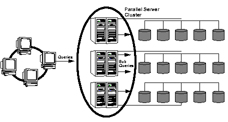

OPQ on Oracle Parallel Server
Oracle Parallel Server provides the framework for the Parallel Query Option to work between nodes. The OPQ behaves the same way in Oracle with or without the Parallel Server Option. The only difference is that Oracle Parallel Server enables OPQ to ship queries between nodes so that multiple nodes can execute on behalf of a single query. Here, the server breaks the query up it into smaller operations that run against a common database which resides on shared disks. Because it is performed by the server, this parallelism can occur at a low level of server operation, rather than at an external SQL level.
In some applications, an individual query often consumes a great deal of CPU resource and disk I/O (unlike most online insert or update transactions). To take advantage of multi-processing systems, the data server must parallelize individual queries into units of work which can be processed simultaneously.
If the query were not processed in parallel, disks would be read serially with a single I/O. A single CPU would have to scan all rows in a table. With the query parallelized, disks are read in parallel, with multiple I/Os.
Several CPUs can each scan a part of the table in parallel, and aggregate the results. Parallel query benefits not only from multiple CPUs but also from greater I/O bandwidth availability.
OPQ can run with or without the Oracle Parallel Server. Without the Oracle Parallel Server option, OPQ cannot perform multi-node parallelism. Oracle Parallel Server optimizes Oracle8 Enterprise Edition running on clustered hardware, using a parallel cache architecture to avoid shared memory bottlenecks in OLTP and decision support applications.
Figure 1-4 Parallel Query Operation
