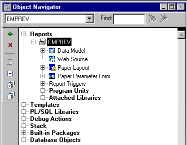

The Object Navigator now displays the emprev report

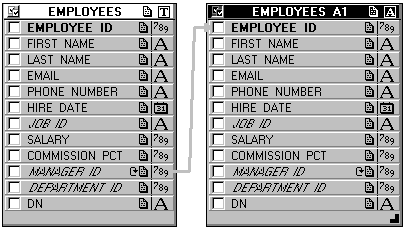

  7. In the Query Builder, double-click the EMPLOYEES table.
  8. Double-click the EMPLOYEES table again, then click Close.
Figure 2-3 Employees Tables displaying in the Query Builder
Text description of adddata_qb.gif follows.
The EMPLOYEES table displays in the Query Builder as EMPLOYEES and EMPLOYEES A1. The link between the MANAGER ID in EMPLOYEES and the EMPLOYEE ID in EMPLOYEES A1 is automatically created because of the constraints that exist in the EMPLOYEES table.
You'll notice that some of the column names are italicized. Column names that are in italics are primary keys or foreign keys.

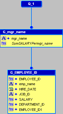

    Figure 2-4 Data Model view for the report
    Text description of adddata_dm.gif follows.
    A Reports-level summary displays in the upper left-hand section of the Data Model view, but is not displayed in this image.
