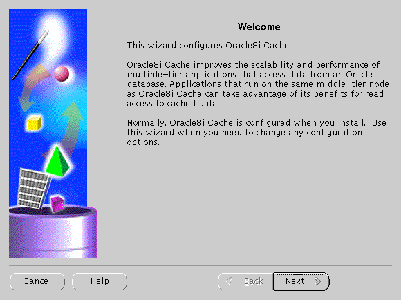

The following steps guide you through the Oracle9iAS Database Cache Configuration Assistant:
The Welcome screen introduces you to the Oracle9iAS Database Cache Wizard.

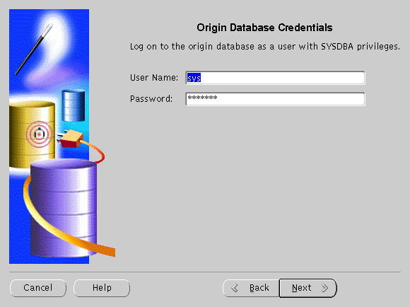

The Origin Database Credentials screen specifies the database that is the original and primary storage for the data that you cache on the middle-tier node.

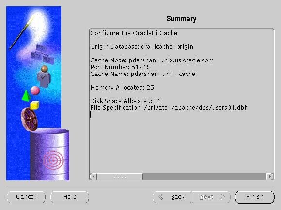

The Summary screen provides information about the origin database, cache node, port number, cache name, memory, disk space allocated and file specification.

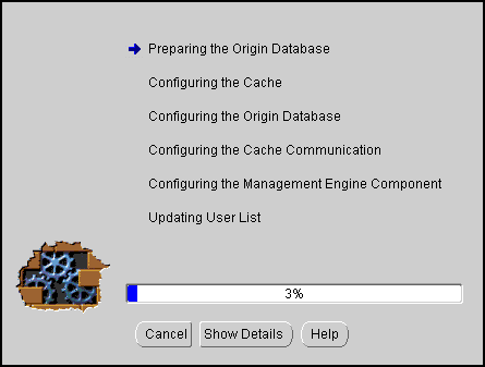

The Cache Configuration Assistant Progress screen informs you of the results of the configuration.

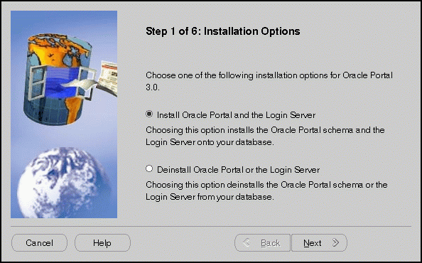

The following steps guide you through the Oracle9iAS Portal Configuration Assistant:
The Installation Options screen allows you to install and deinstall Oracle9iAS Portal. Selecting "Install Oracle9iAS Portal and the Login Server" installs the Oracle9iAS Portal schema and the Login Server onto your database.

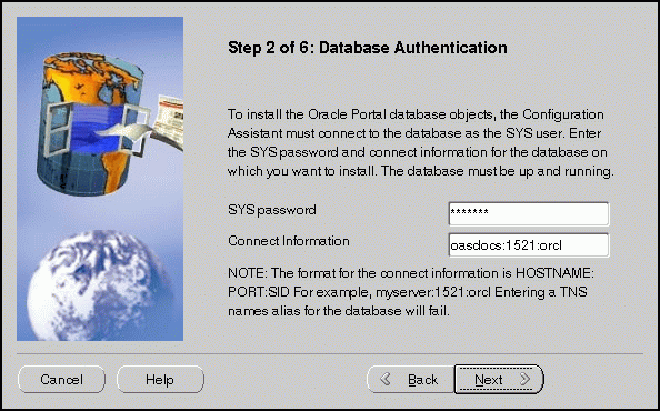

The Database Authentication screen allows you to specify the database connection information granting the Configuration Assistant database access to install the Oracle9iAS Portal database objects.
SYS
password for the database on which you want to install Oracle9iAS Portal database objects. When an Oracle database is created, the user SYS
, identified by the password CHANGE_ON_INSTALL
, is automatically created and granted the DBA
role.
HOSTNAME:PORT:SID
Example: oasdocs:1521:oasdocs
where hostname
is the domain name and machine where you want to install Oracle9iAS Portal, port
is the port number on which the Oracle8i database is running, and SID
is the database name which uniquely identifies a node's instance.

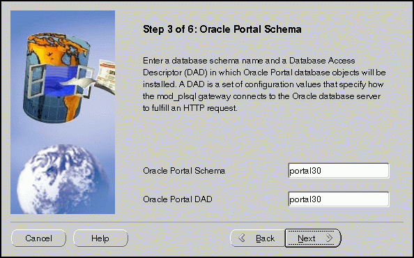

Oracle9iAS Portal Schema screen allows you to enter the Schema and DAD name. These must match the Oracle9iAS Portal Schema and DAD name you entered during the installation process on the Apache Listener Configuration for Oracle9iAS Portal (DAD and Schema name) screen. The default is portal30

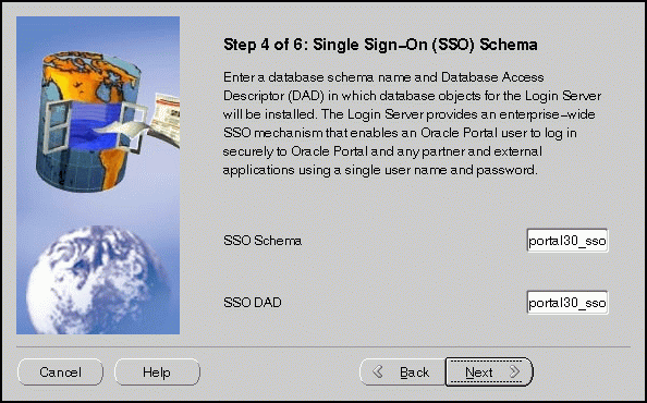

Single Sign-On Schema screen allows you to enter the SSO Schema and DAD name. These must match the SSO Schema and DAD name you entered during the installation process on the Apache Listener Configuration for Oracle9iAS Portal (Login Server) screen. The default is portal30_sso

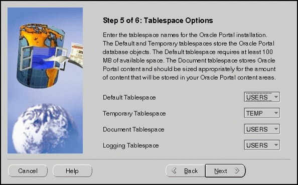

Tablespace Options screen allows you to enter the tablespace names for Oracle9iAS Portal. Choose from the list of tablespaces. For more information, refer to Table A-1.

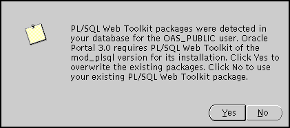

PL/SQL Web Toolkit screen appears only if the configuration assistant detects that PL/SQL Web Toolkit packages already exist on your machine. Click Yes to overwrite the existing packages, or click No to keep the existing PL/SQL Web Toolkit packages.

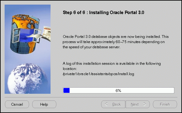

Installing Oracle9iAS Portal screen displays a database objects installation progress bar. Please be patient and refrain from using your machine while this is underway. This process may a take long time to complete.

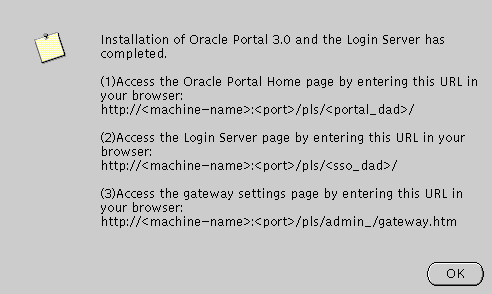

Summary screen appears at the end of installation. It reveals information about accessing the Oracle9iAS Portal Home page, Login Server page and the gateway settings page. For your convenience, make note of this information before clicking OK.
ORACLE_HOME/assistants/opca/install.log

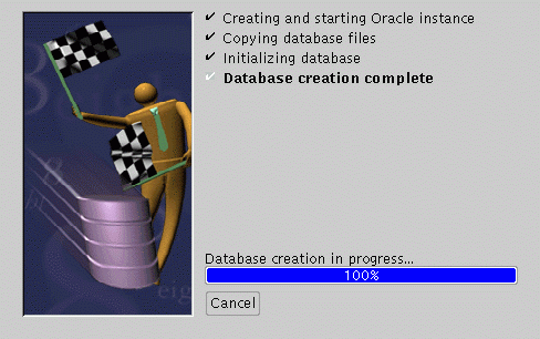

The Oracle Database Configuration Assistant creates a database that is used as a container for Oracle Enterprise Java Engine. The following screen appears as the configuration assistant creates the database:
Oracle Database Configuration Assistant does not require any user input. Once the database creation process ends, the following screen appears.

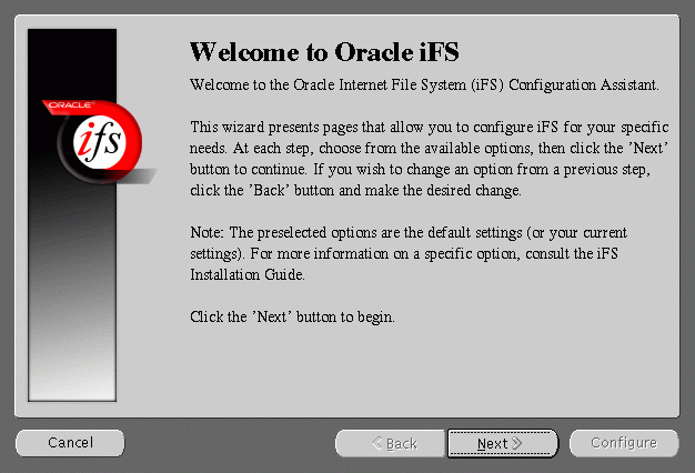

The Welcome screen introduces you to the Oracle Internet File System Configuration Assistant and allows you to review the licensing agreement before you can proceed to configure Oracle Internet File System.

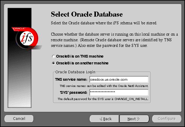

Select Oracle Database screen allows you to choose where the Oracle Internet File System schema will be stored. Select whether the origin database is on the local machine or on the remote machine other than the Oracle Internet File System server machine currently being configured.
If you select Oracle8i on THIS machine, then you will have to fill in the SYS
password field.
If you select Oracle8i on another machine, then you will have to enter the TNS service name and the SYS
password in their respective fields.

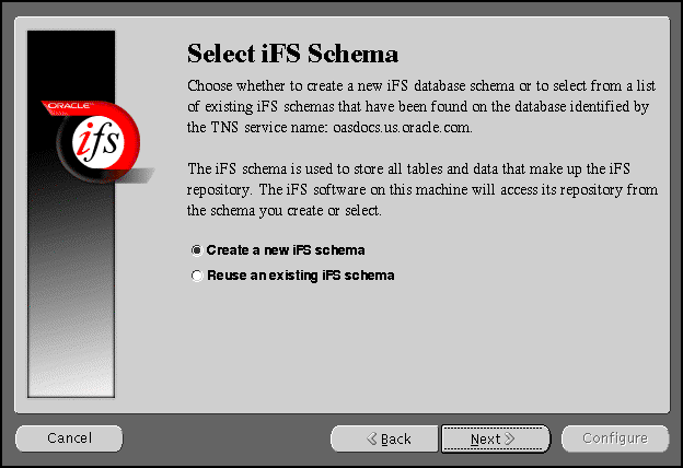

The Select iFS Schema screen allows you to either create a new iFS schema or select from a list of existing iFS schemas that have been found on the database identified by the TNS service name you specified.
If you select "Create a new iFS schema", then click Next to proceed with the instructions provided.
If you select "Reuse an existing iFS schema", then click Next. The following screens will appear:

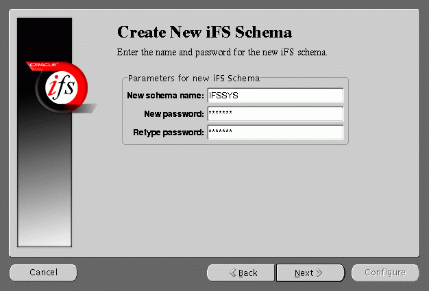

Create New iFS Schema screen allows you to specify an Oracle database username and password for the new schema.
ifssys
If you choose to create a new schema with the same name as an existing schema, a warning message appears. Creating a new schema with the same name as an existing schema will drop the existing schema.

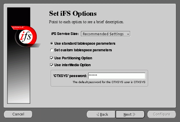

Set iFS Options screen allows you to set certain schema options and to select a service size for your Oracle Internet File System server. There are two choices for the Oracle Internet File System server size:
If you are creating a new Oracle Internet File System schema, then you can choose whether to use standard tablespace parameters, or to specify custom tablespace parameters.
SYSTEM
tablespace, which is usually found under ORACLE_HOME/oradata/global_dbname
. Oracle recommends storing each of these tablespaces on separate disks for best performance.
- Primary: Stores metadata for documents. information about users and groups, and other Oracle Internet File System data.
- Non-Indexed Medias: Stores the LOB data for documents that are not indexed by interMedia, such as image, audio, and video files.
- Indexed Media: Stores the LOB data documents that are indexed by interMedia, such as text and word processing files.
- interMedia Index: Stores the Oracle indexed on interMedia data.
- interMedia Keymap: Stores the mapping between interMedia Text information and Oracle Internet File System information.
- interMedia Data: Stores the interMedia data about Oracle Internet File System documents.
- Partioning Option: Improves performance. Available only with Oracle8i Enterprise Edition.
- interMedia Option: If you have installed interMedia Text, then select this option to use interMedia Text for searching document contents.
- CTXSYS: If you choose the interMedia Text option, then enter the password for the interMedia CTXSYS
account. The default password is CTXSYS.

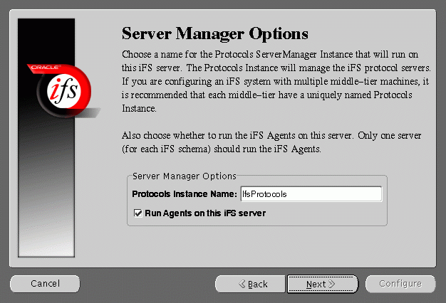

Server Manager Options screen allows you to enter a name for the Protocols Server Manager Instance that will run on this Oracle Internet File System server.

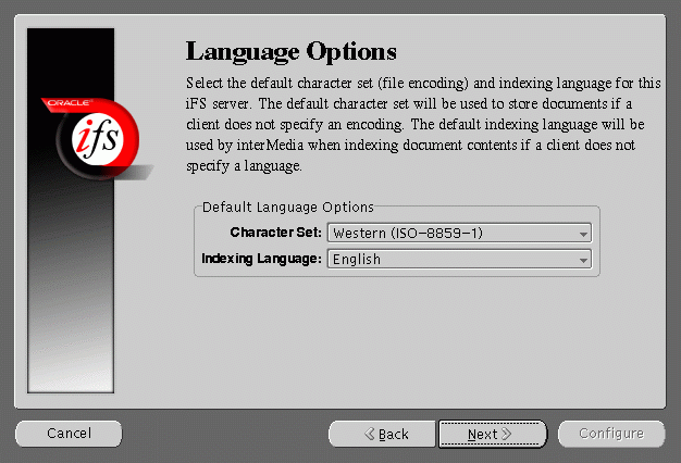

Language Options screen allows you to select the Character set and indexing language for this Oracle Internet File System server.

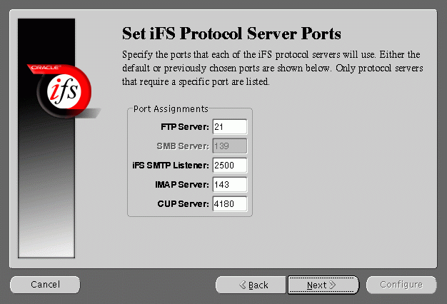

Set iFS Protocol Server Ports screen allows you to set port numbers for the protocol servers you selected in the previous screen. The following is a list of protocol servers and their default port numbers:
When you click the Next button, the port availability on your computer is tested. If a port is already in use, a warning screen appears. A common port conflict can arise because the standard Solaris installation includes a FTP server on port 21, which conflicts with the Oracle Internet File System FTP server. You must resolve such conflicts before starting the Oracle Internet File System protocol servers.

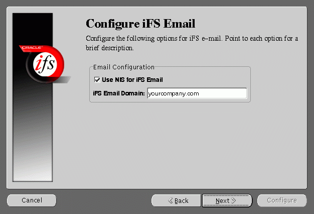

Configure iFS Email screen allows you to enter the iFS Email domain.

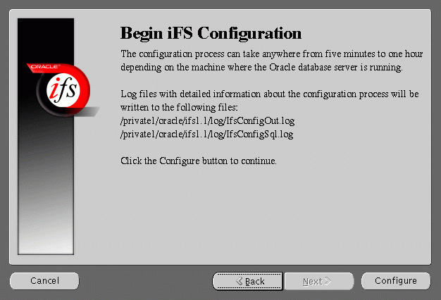

Begin iFS Configuration screen informs the users of the configuration process, and displays the location for the log files.
Once you have started the configuration process, a progress window appears. indicating the progress of the Oracle Internet File System configuration. If an error occurs, check the log files that are displayed on the Begin iFS Configuration screen.

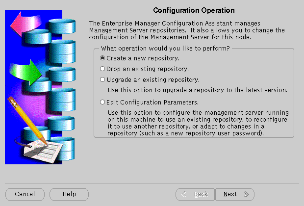

Configuration Operation Screen allows you to create, drop, or upgrade a repository. It also enables you to edit your configuration parameters.

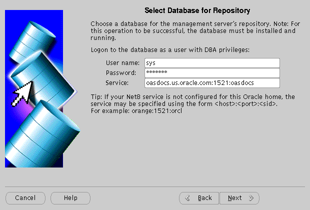

Select Database for Repository screen allows you to enter database information for the management server's repository. Be sure to log in as a user with DBA
privileges.

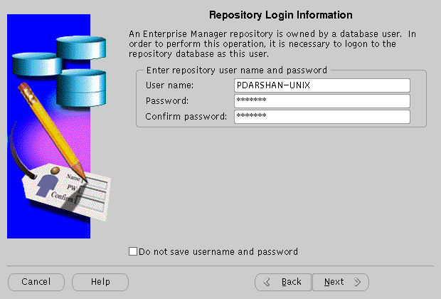

Repository Login Information screen allows you to enter the login username and password for the database user.

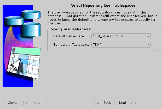

OEM_REPOSITORY
tablespace, or use an existing tablespace, and click Next.
Select Repository User Tablespaces screen allows you to choose between creating a new OEM_REPOSITORY
tablespace, or using an existing one.

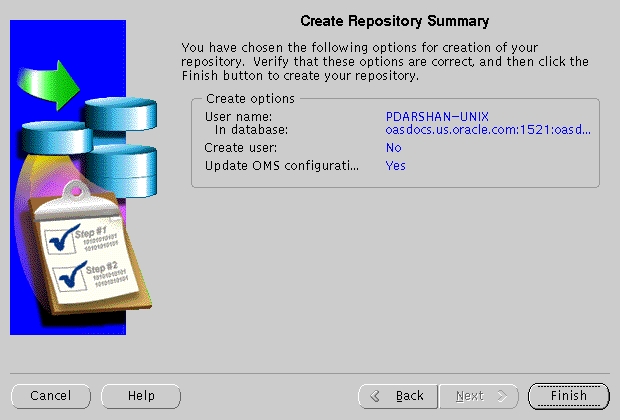

Create Repository Summary screen displays all your repository settings. Be sure to verify them for accuracy.
