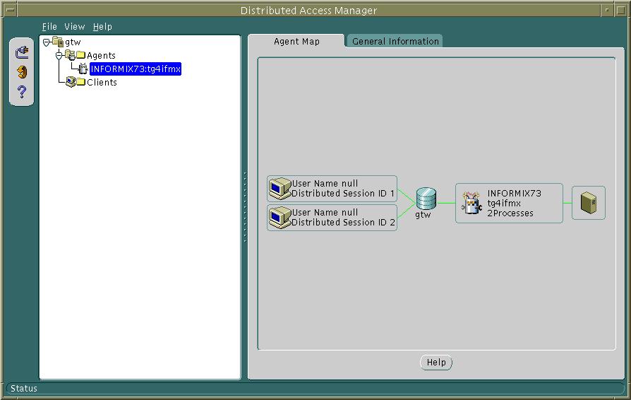

The Distributed Access Manager is used for monitoring distributed sessions that involve non-Oracle systems. The tool is distributed and installed with Oracle Enterprise Manager and runs as a standalone application.
Start the Distributed Access Manager as follows:
oemapp damgr
Using Distributed Access Manager requires connecting to an instance of an Oracle database. Once connected, the tool displays all of the gateways currently registered with the server. For each active gateway, runtime information about the gateway is displayed. It contains the machine on which the gateway runs, its process ID, and the operating system user who started the gateway. The modules supported in the gateway are also listed.
In addition, data about the current sessions through this gateway are available. Sessions are tied to the gateway by the gateway's class and instance ID, which uniquely identify the gateway. The parent client session of the distributed session is described in terms of the client program, the user/schema that owns the session, the session ID, the status, and the terminal.
Information about the database link that was used for establishing the distributed connection, the startup time, and the set of initialization parameters used for the session is also available.
All of the runtime information is derived from dynamically updated V$ tables. The Distributed Access Manager has a refresh capability available through the menu and toolbar that allows users to rerun queries if necessary and update the data. When the data is refreshed, the tool verifies that the set of registered agents remains the same. If it is not, the global view is updated.
