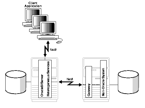

Figure 3-1, "Gateway Component Configuration", is a system diagram that gives an example of one possible system configuration. To sketch your own system, first draw a box. This represents a single system. Next, for each component you wish to install on the system, draw a box inside the box representing your system. Label these boxes with their respective component names. Follow the same procedure to represent a second system.
Draw a line with an arrow on both ends between the two systems to represent communication between them. Draw a box or boxes to represent client applications, and draw a line between them and the Oracle database server to represent communications between the client applications and the Oracle database server. Label the machines on which the Oracle database server, the gateway, and the non-Oracle database reside.

Figure 3-1 Gateway Component Configuration
This illustration is explained by the following text
Figure 3-1, "Gateway Component Configuration", is a system diagram that gives an example of one possible system configuration. In this diagram, the Oracle8i database server, which includes Heterogeneous Services and the database files, resides on a single machine. Client applications access the server over Net8. The gateway and its respective non-Oracle system and database reside on a second machine. The two systems communicate over Net8 so that the Oracle database server accesses the non-Oracle system through the gateway.
