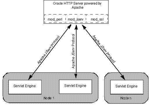

Apache JServ is made up of an Apache module called mod_jserv
, which runs in the httpd process, and a servlet engine, which runs in a Java process. mod_jserv
, which is implemented in C, functions as a dispatcher, routing each servlet request to a JServ process for execution.
The servlet engine runs in its own JVM (Java Virtual Machine) and is solely responsible for parsing the request and generating a response. As Figure 5-1 shows, multiple JServs can service requests. The HTTP server process and the JServ process communicate using the Apache JServ Protocol 1.2.
