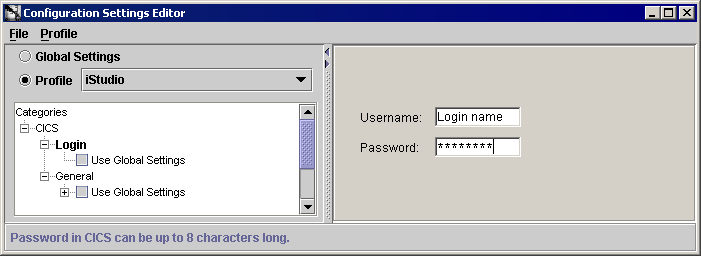

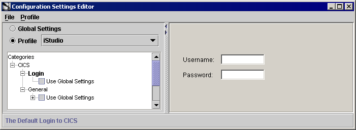

Configuration Editor Login
In the CICS adapter, the configuration dialog allows the user to set the login and password for the CICS region.
To set the login information:
- Click Login on the Login dialog.
Figure 7-2 Configuration Editor Login Screen
- Enter a username in the Username field. A username in CICS can be up to eight characters long.
- Enter a password in the Password field. A password in CICS can be up to eight characters long. The password is stored encrypted in the registry.

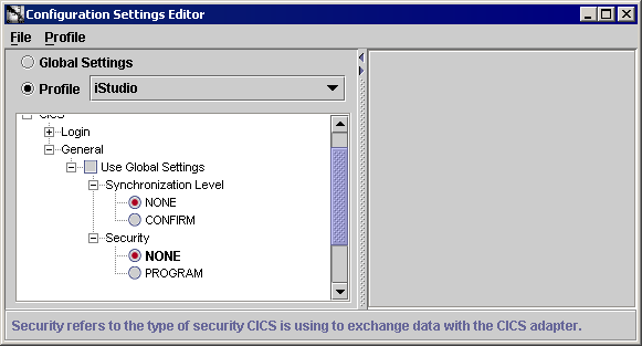

General
General settings only apply to the SNA LU 6.2 protocol. This section will explore the General settings that need to be set in the Configuration Editor for the CICS adapter. In the General Setting section, you can define the Synchronization Level and Security. From the Configuration Settings Editor dialog:
- Expand the General branch.
- Expand the Use Global Settings branch.
Mode Name
To use a different Mode Name, enter the name of the Mode Name. The Mode Name must be defined in both your local and remote system network architecture servers. If you have any questions, please refer to your communication system administrator.
In the Synchronization Level section, you can define the type of confirmation the remote CICS system requires when exchanging buffers with the CICS adapter.
- Expand the Synchronization Level branch.
Figure 7-3 Configuration Settings Editor - Synchronization Level
- Click None if there will be no confirmation when exchanging buffers with the CICS adapter.
Click Confirm if there will be confirmation.
Configuration Editor Security
In the Security section, you can define the type of security CICS is using to exchange data with the CICS adapter.
- Expand the Security branch.
Figure 7-4 Configuration Settings Editor - Security section
- Click None if there will be no security when exchanging data with the CICS adapter.
Click Program if there will be security when exchanging data.
