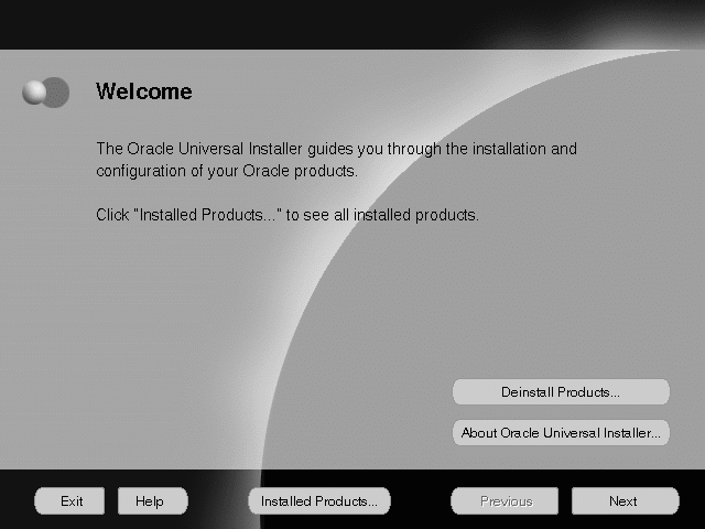

% ./runInstaller
The ./runInstaller command launches the OUI and displays the Welcome screen.
Figure 2-1 OUI Welcome Screen
The following table provides information about OUI screen buttons.

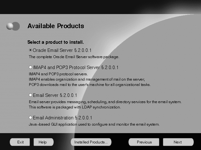

Task 5: Select Available Products
At the Available Products screen, select the eMail Server products to install.
Figure 2-3 OUI Available Products Screen
Select the product to install and click Next to display the Summary screen.

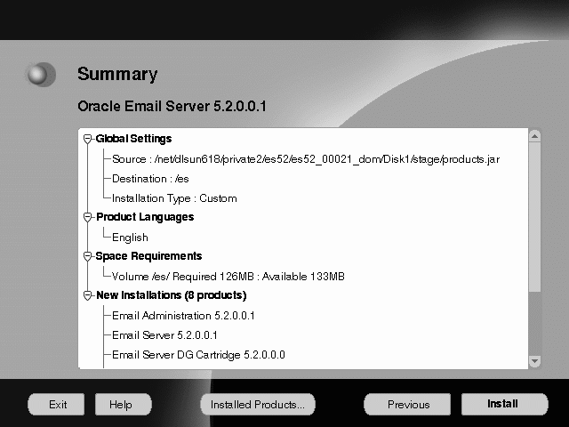

Task 6: Verify Installation Settings
Verify your installation settings at the Summary screen. The settings include the source and destination locations you specified; the installation type you selected; the product language; the space requirement for installation, and the space currently available; and the eMail Server products that will be installed.
Figure 2-4 OUI Summary Screen
- To change the source or destination location, or installation type, click Previous to return to the appropriate screen.
- To begin the installation, click Install to display the Install screen.

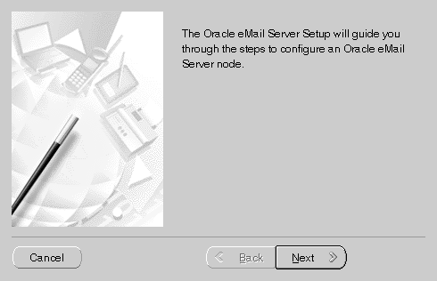

Task 1: Start the Configuration Assistant
The Configuration Assistant is designed to aid in configuring Oracle eMail Server. Launch the Configuration Assistant screen automatically or manually.

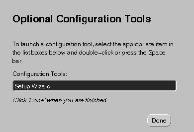

- From the End of Installation screen, select the Configuration Tools button to display the Optional Configuration Tools screen.
Figure 2-5 Optional Configuration Tools Screen
Double click on Setup Wizard in the Configuration Tools field to display the Configuration Assistant screen.

Using the Configuration Assistant
The Configuration Assistant helps configure eMail Server.

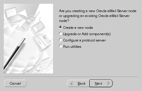

Click Next to display the Configuration Type screen.
Task 2: Select the Configuration Type
The Configuration Type screen allows you to select the appropriate configuration for your installation. Use the table below to choose which is right for you.
Figure 2-7 Configuration Type Screen
Select the appropriate configuration type and click Next.
Task 3: Create a New Node

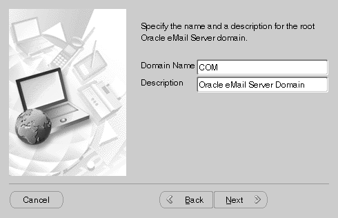

When you select Create a new node from the Configuration Type screen, the First Domain screen displays.
Figure 2-8 First Domain Screen
To install a new Oracle eMail Server, type the domain name and the domain description in the corresponding fields and click Next. The Default/Custom Install screen displays. Some examples of domain names are com, gov, org, and edu.
Write down the domain name you choose, as you will need it later.

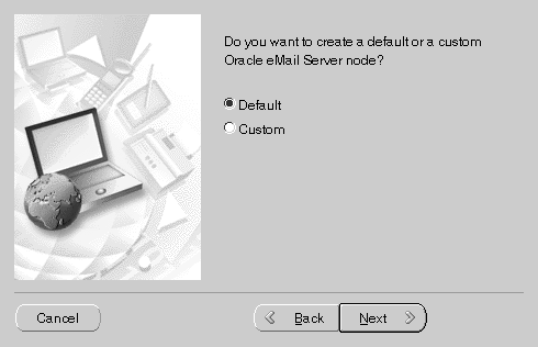

Figure 2-9 Default/Custom Install Screen
Make your selection and click Next. The next screen displayed will ask you if you have an existing database. eMail Server cannot be installed unless there is an existing database. Select Yes and click Next to proceed.

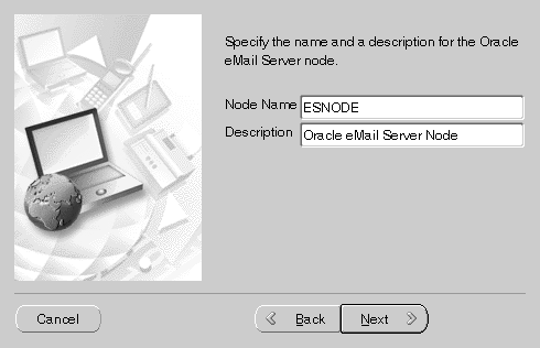

Figure 2-11 Node Information Screen
- At the Node Information screen, if you choose not to use the default node name and description of ESNODE and Oracle eMail Server, respectively, enter your node name and description and click Next.
If you choose to change the node name and description at this time, be sure to write down the node name you choose, because you will be asked to enter it later. Also, you may change the values of these two fields, and the values of subsequent fields, later.
The First Community screen displays.

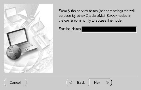

Figure 2-13 TNS Connection Screen
At the TNS Connection screen, specify the service name or connect string in the Service Name field that will be used by other Oracle eMail Server nodes in the same community to access this node. Click Next to display the Time Zone screen.

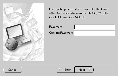

At the User Account, enter the eMail Server database password and confirmation password in the corresponding fields and click Next. The eMail Protocol screen displays.
Remember to write down the passwords you entered for Steps 5 and 6.

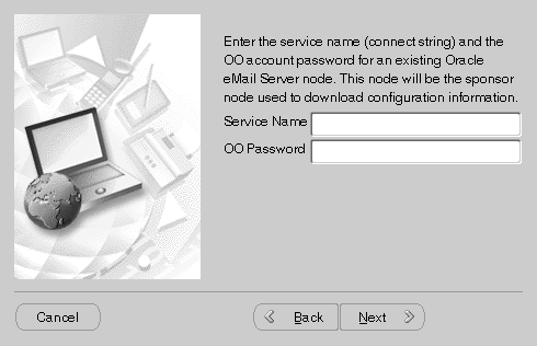

Figure 2-17 Sponsor Node Screen
Enter the service name and OO password and click Next. The Node Definition screen displays.

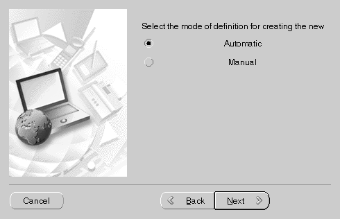

At the Node Definition screen, select the mode of definition for creating the new Node and click Next. The New Domain screen displays.

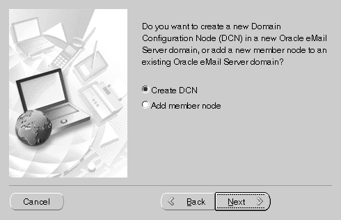

Figure 2-19 New Domain Screen
At the New Domain Screen, choose one of the following:
Creating a New Domain Configuration Node
Additional domain configuration nodes must be installed on a different database, with a different $ORACLE_HOME, from the initial installation.
To create a domain configuration node (DCN), select Create DCN from the New Domain screen (see Figure 2-19) and click Next. The Domain Parent screen displays.

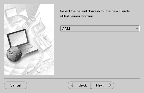

Figure 2-20 Domain Parent Screen
- Click the drop down list, select the parent domain, and click Next. The Domain Information screen displays.

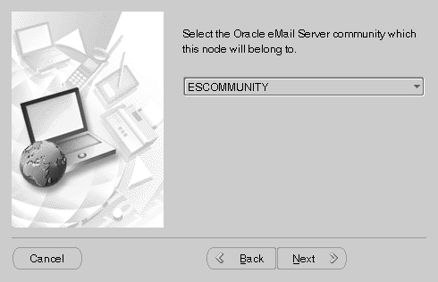

Figure 2-23 Select Community Screen
At the Select Community screen, select the Oracle eMail Server community of the node from the dropdown list and click Next. The TNS Connection screen displays (see Figure 2-13).

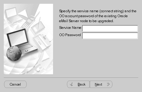

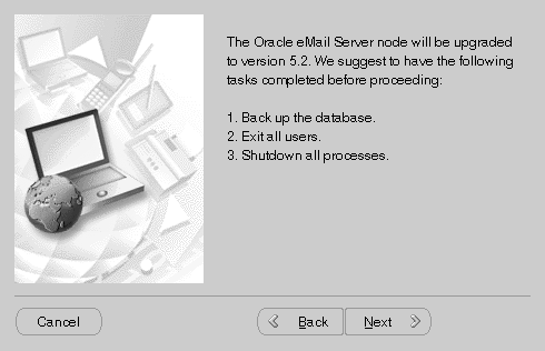

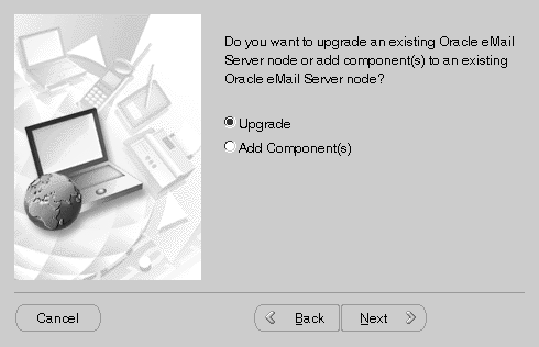

Task 5: Upgrade an Existing eMail Server Node
Before running setup wizard to upgrade to eMail Server Version 5.2, the user has to copy all config files from the old

From the Configuration Type screen (see Figure 2-7), select Upgrade or Add component(s) and click Next. The Upgrade screen displays.
Figure 2-24 Upgrade Screen
From the Upgrade screen, select Upgrade and click Next. The Existing Node screen displays.
Figure 2-25 Existing Node Screen
At the Existing Node screen enter the Service Name and OO Password and click Next. The Begin Upgrade screen displays.
Figure 2-26 Begin Upgrade Screen
Once you have completed the steps listed, click Next. The DCN Version screen displays.

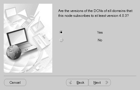

Figure 2-27 DCN Version Screen
If the DCN version is 4.03 or greater, select Yes. Otherwise select No and click Next. In either case, the following steps and screen displays are the same.
- To determine your DCN version, enter:
% oomgr
The computer returns the following:
Oracle eMail Server Manager: Release #
The Release # is your version.

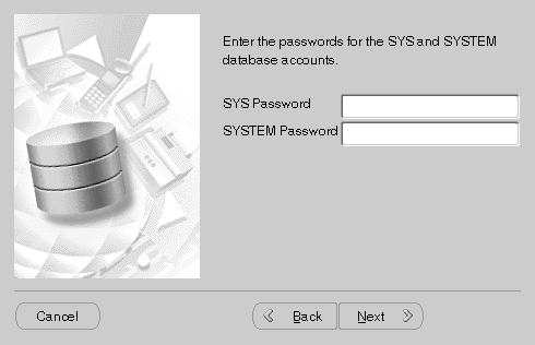

Figure 2-28 Database User Screen
At the Database User screen, enter the SYS and SYSTEM Passwords and click Next. The CTXSYS User screen displays.

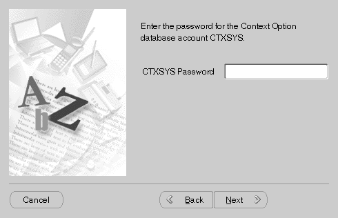

Figure 2-29 CTXSYS User Screen
If you installed Oracle interMedia prior to installing Oracle eMail Server, then enter in your CTXSYS password as instructed in Step #6. If you did not install Oracle interMedia prior to Oracle eMail Server, the Configuration Assistant skips the CTXSYS screen.
At the CTXSYS User screen, enter in the CTXSYS password (the default CTXSYS Password is CTXSYS) and click Next. The Begin Setup screen displays.

Task 6: Add Components to an Existing Node
From the Configuration Type screen (see Figure 2-7), select Upgrade or Add component(s) and click Next. The Upgrade screen displays (see Figure ).
- Select Add Components and click Next. The Existing Node screen displays (see Figure ).
- At the Existing Node screen, enter the service name and OO password and click Next. The Email Protocol screen displays.
Task 7: Configure a Protocol Server
This section describes the procedures for configuring a protocol server.
- From the Configuration Type screen (see Figure 2-7), select Configure a protocol server and click Next. The Existing Node screen displays (see Figure ).
- At the Existing Node screen, enter the service name and OO password and click Next. The Guardian screen displays.

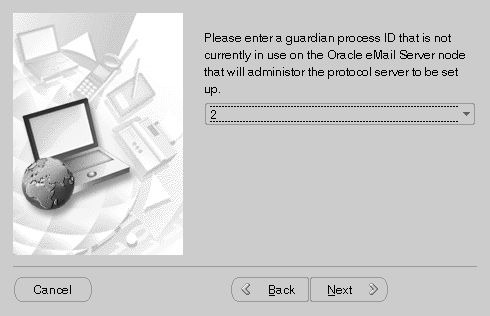

Figure 2-30 Guardian Screen
Select a Guardian Process ID that is not being used by the eMail Server node, and click Next.

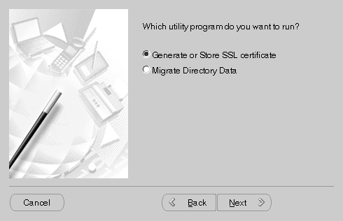

- At the Configuration Type screen (see Figure 2-7), select Run Utilities and click Next. The Utility screen displays
Figure 2-31 Utility Screen

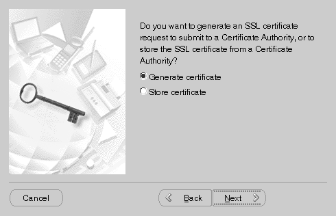

Select Generate or Store SSL Certificate and click Next. The Generate SSL screen displays.
Figure 2-32 Generate SSL Screen
Select Generate Certificate and click Next. The Certify SSL screen displays.

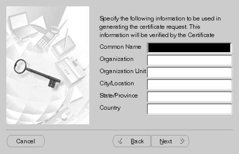

Figure 2-33 Certify SSL
Specify the Common Name, Organization, Organization Unit, City/Location, State/Province, and Country. See the table below for more information.Click Next to display the SSL Contact screen.

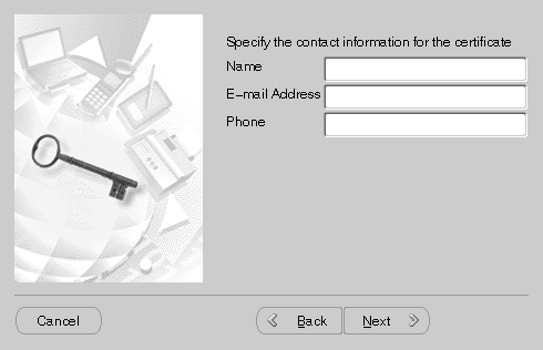

Figure 2-34 SSL Contact Screen
Specify the contact information for the certificate and click Next. The SSL Password screen displays.

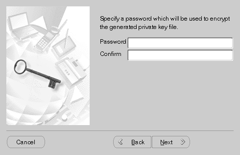

Figure 2-35 SSL Password Screen
Enter the password and click Next. The SSL Processing screen displays.

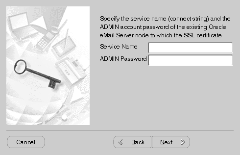

Storing an SSL Certificate
Use the following procedure to store an SSL certificate.
- At the Configuration Type screen (see Figure 2-7), select Run Utilities and click Next. The Utility screen displays.
- Select Store certificate and click Next. The SSL Admin screen displays.
Figure 2-36 SSL Admin Screen
At the SSL Admin screen, enter the service name and admin password and click Next. The SSL/Protocol screen displays.

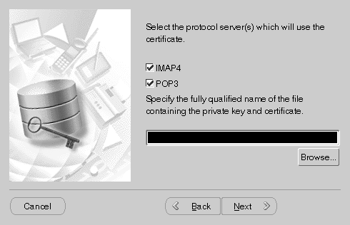

Figure 2-37 SSL/Protocol Screen
At the SSL Admin Password screen, enter the service name and admin password and click Next. The SSL/Protocol screen displays.
At the SSL/Protocol screen, select the protocol server or servers that will be using the SSL certificate. You can select one or both protocol servers.
Enter the file location of the private key and certificate. You can also click Browse to find the location.
Click Next. The Password Specification screen displays.
At the Password Specification screen, enter the password you want to use to encrypt and decrypt the private key.
In the Confirm field of the Password Specification screen, enter the password again to confirm the password and click Next. The Generate Certificate Request screen displays.
Click Next to generate the certificate, or click Cancel to exit the Configuration Assistant.

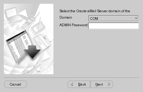

Figure 2-38 Migration Screen
Select the domain, specify your admin password, and click Next. The LDAP Migration screen displays.
Click Next to start directory data migration, or click Cancel to exit the Configuration Assistant.

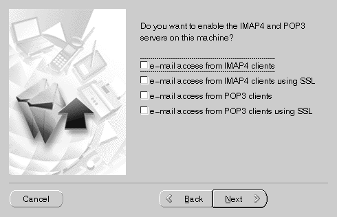

Task 9: Enable the IMAP4 and POP3 Servers
You have been directed to this part of the installation from various locations depending upon which configuration you are using. Use the following procedure to enable IMAP or POP3 servers.
- At the Email Protocol screen, select the IMAP4 and POP3 servers you want to enable and click Next.
- You can select more than one option. The SMTP Gateway screen displays.

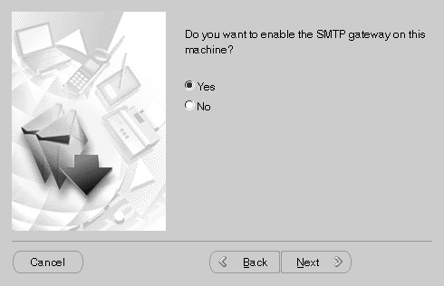

Task 10: Enable the SMTP Gateway
Use the following procedure to enable SMTP.
- At the SMTP Gateway screen, select Yes and click Next. The Gateway screen displays.

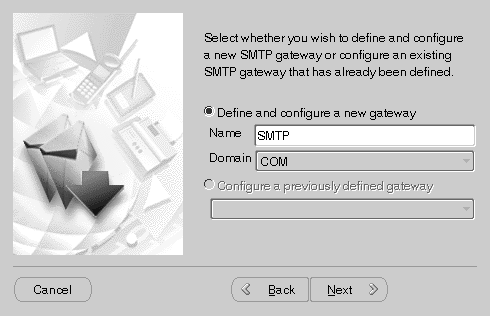

At the Gateway screen, select Define and configure a new gateway or Configure a previously defined gateway, and click Next. The SMTP Information screen displays.

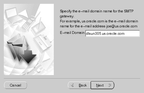

Figure 2-42 SMTP Information Screen
At the SMTP Information screen, enter the e-mail domain for the SMTP gateway and click Next. The LDAP screen displays.

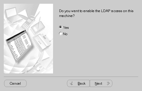

Figure 2-43 LDAP Screen
If you do not want to enable LDAP, select No and click Next. Go to "Task 12: Complete the Configuration"
Task 11: Enable LDAP
- To enable LDAP, at the LDAP screen, select Yes and click Next. The LDAP Server screen displays.

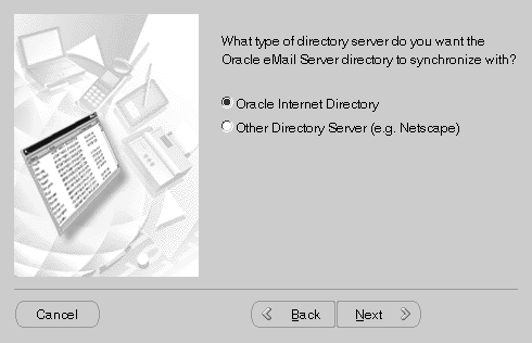

Figure 2-44 LDAP Server Screen
At the LDAP Server screen, select the directory server with which you want the eMail Server directory to synchronize and click Next. The Synchronization screen displays.

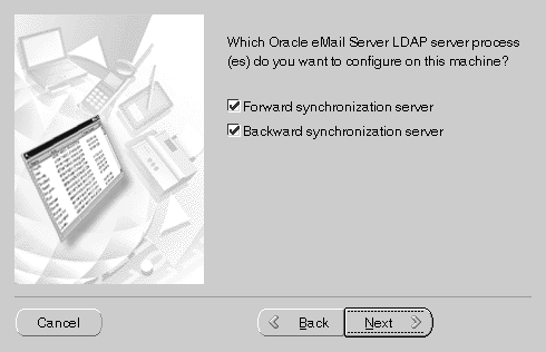

Figure 2-45 Synchronization Screen
At the Synchronization screen, select the server process or processes you want to configure. You can select more than one. See the table below for more information.
Once you have made your selection, click Next.

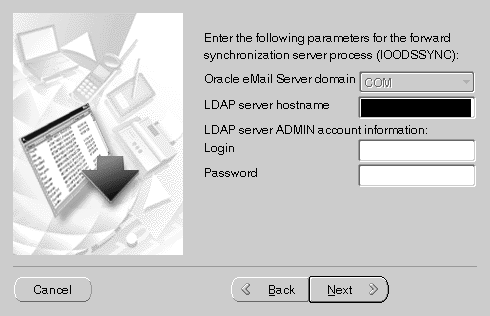

Forward Synchronization Parameters
- From the Synchronization screen, select Forward synchronization server (or both Forward and Backward synchronization server) and click Next. The Forward Synchronization screen displays.
Figure 2-46 Forward Synchronization Screen
Enter the LDAP server hostname and the LDAP server ADMIN account login and password, and click Next.

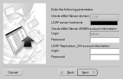

Backward Synchronization Parameters
From the Synchronization screen, select Backward synchronization server (or both Forward and Backward sycnchronization server) and click Next. The Backward Synchronization screen displays.
Figure 2-47 Backward Synchronization Screen
- Enter the eMail Server Admin account login and password, and the LDAP Replication_DN account login and password, and click Next. The Database screen displays.

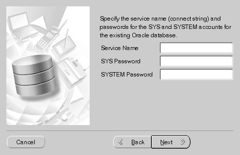

- At the Database screen, you are asked if you have an existing database. Select Yes and click Next. The Database Connection screen displays.
Figure 2-48 Database Connection Screen
At the Database Connection screen, enter the Service Name, SYS Password, and SYSTEM Password, and click Next. The CTXSYS User screen displays (see Figure 2-30).
See "Task 12: Complete the Configuration" to complete this procedure.
