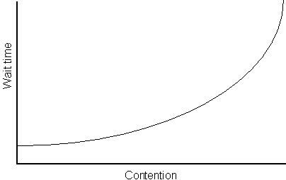

While the service time for a task may stay the same, wait time will lengthen with increased contention. If many users are waiting for a service that takes one second, the tenth user must wait 9 seconds. Figure 1-2 shows the relationship between wait time and resource contention.

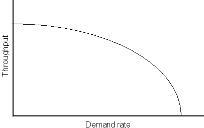

Excessive demand increases response time and reduces throughput, as shown in Figure 1-4. If there is any possibility of the demand rate exceeding the achievable throughput, then determine which parameters should be adjusted (such as ThreadsPerChild
in the Oracle HTTP Server and security.maxConnections
in JServ) and change the configuration accordingly.

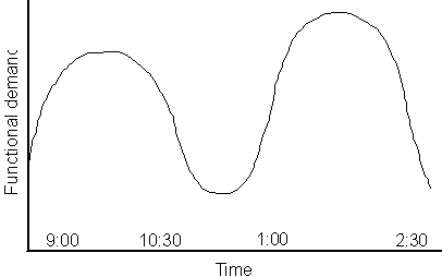

You will also need to determine variances in the load. For example, users might access the system heavily between 9:00am and 10:00am and then again between 1:00pm and 2:00pm, as shown in Figure 1-5. If your peak load occurs on a regular basis, for example, daily or weekly, the conventional wisdom is to configure and tune systems to meet your peak load requirements. The lucky users who access the application in off-time will experience better response times than your peak-time users. If your peak load is infrequent, you may be willing to tolerate higher response times at peak loads for the cost savings of smaller hardware configurations.

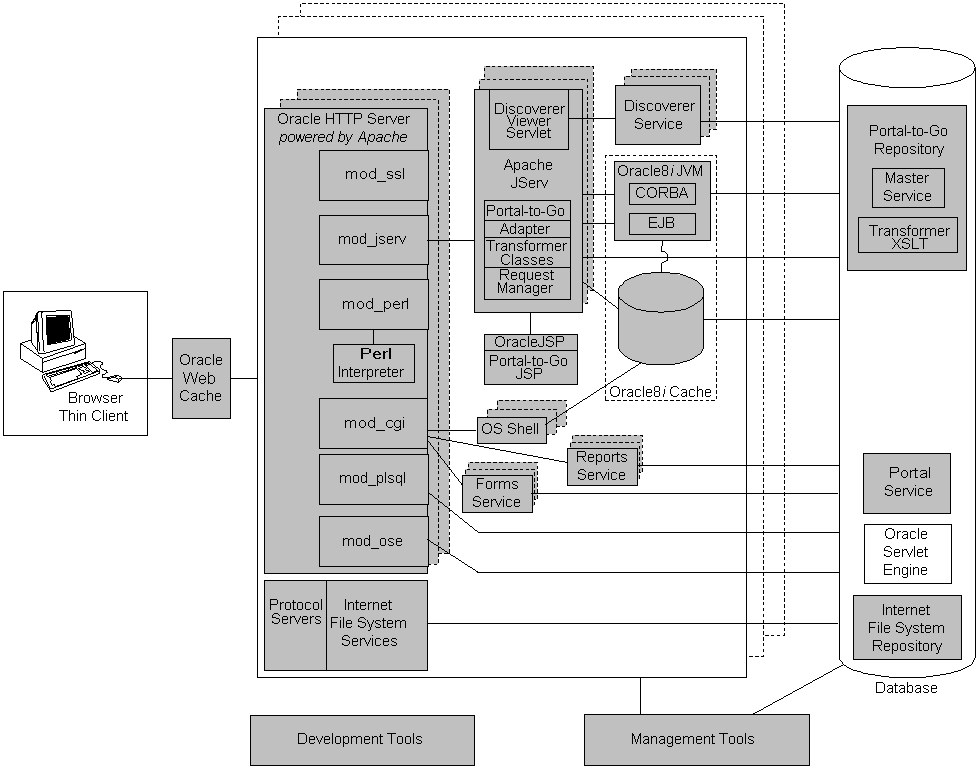

Figure 1-6 shows the architecture of Oracle9i Application Server.
This guide addresses the performance and configuration of these components:
