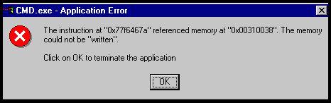

If the value of the user's PATH environment variable is over 1,024 bytes, then the following error may occur when the installer starts up the Oracle HTTP Server process:
This error can be resolved by doing either one of the following:
cmd.exe. The patch is described in Microsoft Knowledge Base article Q268722.
