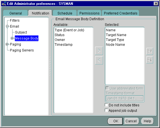

      Email/Paging Message Body Definition
      This page allows you to select the content and format for the body of the email or page message. By default, Name, and Status are selected. You use the left/right arrows to move items back and forth between the Available and Selected lists.
      Figure 6-9 Administrator Notification Preferences: Email/Paging BodyText description of empgbody.gif follows.
      Expanding the Message Body object in the navigator and selecting per Test allows you to use a subset of the following option settings on a per test basis. Refer to "Email Subject Definition" on page 6-35 for more information on manipulating message content.
      • Available: Lists available content.
      • Selected: Lists currently selected content.
      • Use Abbreviated Format: For Type (Job or Event), Status, and Target Type, you can select the Use Abbreviated Format option. The following abbreviations are used by the system:

      Timestamp Format
      This option is available if Timestamp is chosen from the Selected list. You use the pull-down menu to select one of the pre-defined formats.
      Do not include titles
      When selected, classification titles such as Status, Service Name, and Timestamp are omitted from the message.
