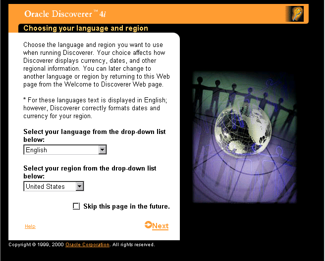

  1. Specify a language and region and click Next.

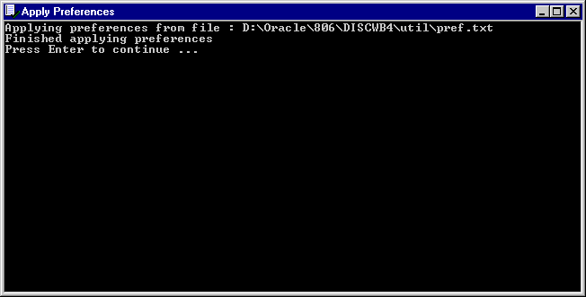

        5. From the Windows Start menu, choose Programs | Oracle Discoverer Server 4i Setup | Apply Preferences.
          A confirmation window shows that the new preferences have been saved. If you suspect that the file contains errors, check the error.txt file in the current directory.
        6. To continue, press the Enter key.
          The Preferences are updated in the Windows NT Registry. Preferences are now set for the Discoverer Services.

          1. Save a copy of the pref.txt file.
          2. Delete the original pref.txt file.
          3. From the Windows Start menu, select Run.
          4. In the Run window, type regedit and press [Enter].
          5. Find the registry key at
            HKEY_LOCAL_MACHINE\software\oracle\WebDisco 4i.
          6. Delete that registry key.
          7. Copy the file <ORACLE_806_HOME>\discwb4\util\defaults.txt" to "pref.txt."
          8. Choose Start | Programs | Oracle Discoverer Server 4i Setup | Apply Preferences.
          9. Run a Discoverer session.
            If the session runs correctly, the original pref.txt file was probably corrupted.
