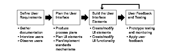

As shown in the Figure 2-2, the process for developing a GUI consists of four major stages:
Figure 2-2 Stages in developing a user interface
The rest of this section offers guidelines for completing each of these stages:
Note: This chapter is not intended to treat the subject of GUI development exhaustively. If you require more detail on how to proceed in a given stage, you may want to visit your local library or computer bookstore. In particular, Jeffrey Rubin's "Handbook of Usability Testing" is an excellent source of information on defining user requirements and gathering user feedback.

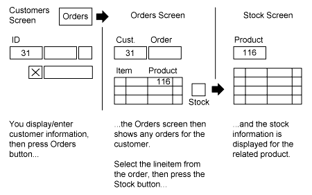

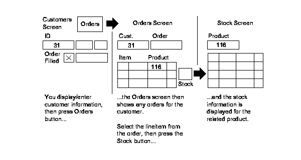

  1. Draft a storyboard to give you a clear picture of how the application will actually look and behave. A storyboard is a frame-by-frame drawing of screens showing transition and appearance. Include a narrative to describe how the screens relate to the tasks you identified when you defined the users' requirements.
    Here is an example of three panels from a storyboard for an ordering application:
Figure 2-3 Example of a storyboard
  1. Show the storyboard to users. Verify that your planned application addresses their needs and supports their tasks the way they perform them.

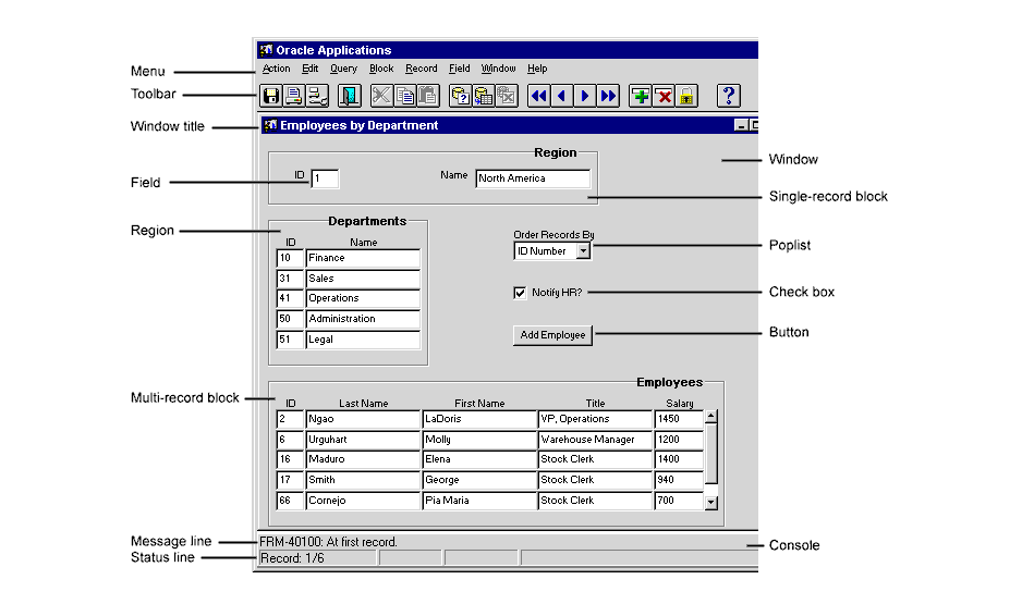

2.2.1.2 What are forms, blocks, items, regions, and frames?
Simply put, a form (or form module) is an application that provides access to information stored in a datasource. When you look at a form, you see interface items such as check boxes, radio groups, and so on, which enables the user to interact with the datasource. These interface items belong to a container called a block. In Figure 2-4, the fields Customer ID, First name, Title, and so on all belong to the same block.
Figure 2-4 Sample form
There are two types of blocks: a data block, which serves as a link between the datasource and the user, and a control block, which is not associated with a datasource. Each data block can enable the user to view and access data from one table in the datasource. Blocks can be single-record blocks, which means that they show one row of data at a time, or multi-record blocks, which enable users to see many rows of data at once. All of the fields in Figure 2-4 are in single-record blocks.
A region is a rectangle or line that separates a logical grouping of fields from others in the block. In Figure 2-4, the rectangle that separates the Customer Information fields from the Accounts icons is a region.
A frame is a pre-defined way of arranging certain items in a block. For example, the block shown in Figure 2-4 was arranged by a frame that established its margins and offsets, the distance between the items and prompts, and so on.

2.2.2.6 Creating regions
The following table presents recommendations for creating regions
Table 2-4 Recommendations for regions
Attribute  Recommendation
General
  • Avoid creating regions or adding boilerplate lines to group items unless doing so is meaningful to the user and improves the usability of the screen.
  • Make the line or rectangle creating the region black, with an inset bevel.
  • Use a frame for regions containing an entire block. A frame has properties that control the layout of the items within it, such as the space between the frame and items (margin), spacing, and visual attributes. Using standard frames ensures the consistency of your window layout. (Although the Layout Wizard creates a frame, you can always override it by applying a frame stored in your object library.)
Title
  • Add a title to the region unless the information contained within is obvious. Use boldface.
  • Position the title on top of the rectangle or line, leaving one leading and one trailing space in the title text.
  • To display the title, use one of these widgets:
Boilerplate (for static region titles)Frame title (for frames)Display item, designed to look like boilerplate (for dynamic region titles)Poplists (for alternative regions)Check boxes (if an entire region is applicable or non-applicable)
2.2.2.7 Adding items to blocks
The following table should help you decide when to choose one form item over another. It also presents some guidelines that you can use if you decide to modify an object or standard in the Standard Object Library. The items are presented in alphabetical order.
Table 2-5 Recommendations for items
Item  When to use  Recommendations
Boilerplate text
  • Use for text that is neither a prompt nor a title.
  • Use mixed case.
  • Avoid overuse of italics and underlining.
  • Use font styles consistently. For example, if you use bold for emphasis, do not use bold for any other purpose.
  • Avoid excessive variations of fonts, sizes and colors.
Buttons (non-iconic)
  • Use as dialog responses (in modal windows) and for item-related actions.
  • Use one of the STD_BUTTON_type objects in the Standard Object Library.
  • Limit six to a window. Arrange in a single row, if possible, or a single column.
  • Align buttons, leaving 0.1" space between them. Separate logical groupings of buttons by 0.5".
  • Leave 0.1" between the right edge of the rightmost button and the right edge of the window.
  • Capitalize label words; for example, `Print Invoice'.
  • Use an ellipsis (...) at the end of a button label if the button opens a modal window or if the user must provide more information about the action in another window (modal or not) before the action can be completed.
  • Place OK and Cancel buttons together.
  • Put affirmative and cancellation buttons first, unique buttons last.
  • Use chevrons (>>) to indicate that the dialog will be expanded.
  • For labelled buttons (except OK and Cancel), always provide an accelerator key (underlined letter).
Use the first letter of the first or second word in the label ("F" for "File" or "P" for "Start Posting"). If a stronger link exists (like "X" for "Exit"), use that letter.Use consonants instead of vowels when possible.Make access keys unique within a window. Ensure they do not conflict with the keys used by the top level of the menu.
Check boxes
  • Use only when the label on the check box can clearly be thought of as having "true" (checked) and "false" (unchecked) states. Otherwise, use a radio button group with two items.
  • Use the STD_CHECKBOX object in the Standard Object Library.
  • Use positive statement labels:
Not good: Don't show this alert in the future.Better: Show this alert in the future.
Display items
  • Use for display-only fields in which the user can never type; for example, the Total field in a financial application.
  • Use the STD_DISPLAY_ITEM object in the Standard Object Library.
Icons
  • Use only for frequent or critical actions.
  • Use where a picture conveniently conveys a task or mimics a real-world object.
  • Place frequently used buttons on a toolbar.
  • Group related tools together and separate groups with white space.
  • Disable buttons that are unavailable.
  • Always provide tooltips, as users are often confused by the meaning of icons.
  • Icons are often cultural. Be aware that you may need to translate them.
  • Avoid "visual puns", such as a running figure for "Run". Their meanings are not obvious, and will certainly not be understood in other languages.
Lists (see also Poplists and T-Lists)
  • Use when it is easier for the user to select a value than to type in a value.
  • Use for data entry and display of text values in a selectable list format.
  • Use when displayed value entries are relatively short (up to 30 characters each).
  • Use the combo-box style if the user may enter new values.
  • For 15 entries or less, use a poplist. For more than 15 entries, use an LOV (List of Values). For more than 30 entries with a lot of real estate, use a T-List.
  • Make all related fields the same length.
  • Use the color of the canvas background for text items that have become non-enterable.
LOVs
  • Use when the user must select from a list of more than 15 rows or to show several columns of data.
  • Automatically select a row for the user when there is only one valid value.
  • Move the cursor automatically to the next field after a selection is made.
  • If there are more than 100 rows in the LOV, prompt the user to reduce the list of valid values before making a selection.
Poplists
  • Use when only one value is applicable and the list of choices is 15 or less.
  • Before implementing a poplist, consider whether frequent users can type faster than they can select.
Pop-up menus
  • Use to associate menu options with an item, rather than the whole application.
  • Use to provide access to frequently used commands.
  • Use the STD_POPUP_MENU_ITEM object in the Standard Object Library.
Prompts
  • Use as labels for fields, check boxes, lists, etc.
  • Place toward the top or left of the element they are describing.
  • Always place single-record blocks prompts to the left of the field and multi-record block prompts above the field.
  • Use the terms "From" and "To" to identify fields involved in a range rather than "Start" and "End" or "Low" and "High".
  • For percentages, place the percent sign (%) after the field. Do not include it in the prompt.
Radio groups
  • Use to present mutually exclusive choices.
  • Use to set a `mode', such as what type of information will be displayed.
  • Use the STD_RADIO_GROUP object in the Standard Object Library.
  • Use vertical orientation instead of horizontal.
  • Group related buttons into radio groups with a title.
  • If the choices are binary (ON/OFF, YES/NO), use a check box instead.
  • Always provide a default value.
T-Lists
  • Use only when one value is applicable and the list of choices is never expected to grow beyond 30.
  • Always show at least five rows of data.
  • Use only in forms with a lot of available real estate.
Text items
  • Use for data entry and display of character values.
  • Use for lengthy or unprepared values (that is, those that do not appear in a short, pre-defined list).
  • Use a bevel if the user can enter values in the field.
  • Use the STD_TEXT_ITEM or one of the STD_DATE_type objects in the Standard Object Library.
2.2.2.8 Designing messages
Messages are shown either in the window console area or in popup windows called alerts. How you display messages depends upon their type and whether a reply is required by the user. Here are some suggestions:
Table 2-6 Displaying messages
Message Type  Recommendations  Example
Errors
  • To present an error message, use the STD_ALERT_STOP object under the Alerts tab in the Standard Object Library.
  • Use when an error is serious enough to halt processing. Include a stop sign icon in the dialog.
  • Use sparingly.
"You do not have sufficient authority to approve this Order."
Warning
  • Use the STD_ALERT_CAUTION_1, STD_ALERT_CAUTION_2, or STD_ALERT_CAUTION_3 objects under the Alerts tab in the Standard Object Library. While in the Library, click the object once to see a description of the message text.
  • Use to present a question that the user must respond to before processing continues. Include a yield sign icon (!) in the dialog.
  • Keep the warning short and concise. For example, use "Delete this order?" rather than "Do you really want to delete this order?"
  • Phrase questions positively ("Save changes?" rather than "Are you sure you don't want to save changes?")
"Copy all lines on this invoice?"
Information
  • Use the STD_ALERT_INFORMATION object in the Standard Object Library.
  • Use to present messages that the user must acknowledge when no choice is involved. Include the information icon (the letter "i" in a circle) and the OK button.
"Line and Shipment Quantities currently do not match."
"There are items awaiting your attention."
Hints
  • Appears on the Form Builder message line in the Console.
  • Use to present messages of very little consequence, or process indicators that do not require a response.
"Working..."
"At first record."
"Processed Order line 12 of 37."
