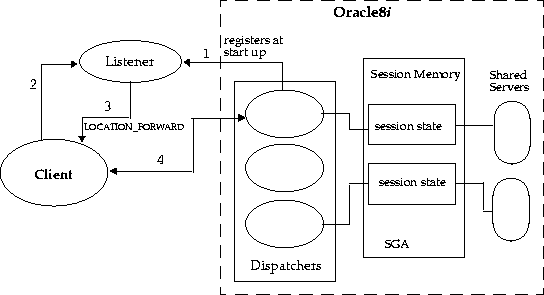

Figure 3-3 shows the interaction between the listener and the dispatchers, and also illustrates how an Oracle8i ORB session is activated.
The incoming request is examined by the shared server services to see if the request is for an existing session. If so, the request is forwarded to the indicated session. If not, the service creates a new database session for the request and activates the ORB in the session. This session is very similar to the database sessions created for incoming Net8 connections. In the session, the ORB reads the incoming IIOP messages, authenticates the client, finds and activates the corresponding server-side objects, and sends IIOP messages as needed to reply to the connected client. Subsequent messages from the client are directed to the existing session.

The administrator for your database configures an MTS server with a dispatcher that is GIOP enabled. In addition, the administrator configures a listener that this dispatcher registers with upon database startup.
When the database does start up, all dispatchers register with all listeners configured within the same database initialization file. However, when an IIOP client invokes a request, the listener will only redirect the request to a GIOP dispatcher or hand off to a generic dispatcher.

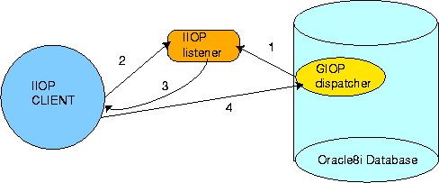

The listener recognizes the IIOP protocol and redirects the request to a registered GIOP dispatcher.
The listener redirects if a GIOP dispatcher is configured. If no GIOP dispatcher is configured, the listener can hand off the request to a generic dispatcher. See "Hand Off to Generic Dispatcher" for more information.

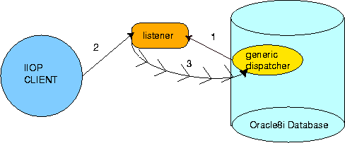

If there is no GIOP dispatcher statically configured, but there is a generic dispatcher configured, the listener can hand off the request to this dispatcher. The only restrictions are that the listener and dispatcher must exist on the same node in order for the hand off to occur and that the listener must be either statically or dynamically configured to receive an IIOP request.
For hand off to occur, the listener forfeits the socket to the dispatcher. Thus, this can only occur within a single node.
Figure 3-5 shows the dispatcher and listener combination in a hand off environment.

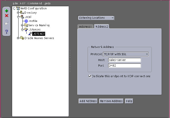

Modify the listener to accept SSL requests on port 2482.
This brings you to the listening port panel, as shown in Figure 3-6.

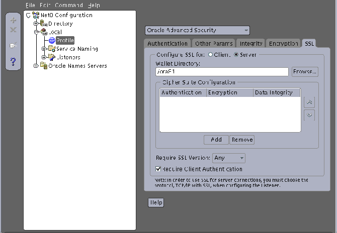

These steps will add wallet and SSL configuration information into both the listener and database configuration files. The SSL wallet location must be specified in both the listener and database configuration files. Both entities must locate the wallet for certificate handshake capabilities.
listener.ora file: ssl_client_authentication=false ssl_version=undetermined
The default is for the database to authenticate the client. If you want the listener to authenticate the client, change the ssl_client_authentication parameter to true.
sqlnet.ora file: ssl_client_authentication=true ssl_version=0 sqlnet.crypto_seed=<seed_info>
If you did not request client authentication, the ssl_client_authentication parameter will be false. The default value is for client authentication to be true. In addition, you can specify a specific SSL version number, such as 3.0, in the ssl_version parameter. The ssl_version value of 0 means that the version is undetermined and will be agreed upon during handshake.
listener.ora and database's sqlnet.ora files, the wallet location is specified:oss.source.my_wallet=(source= (method=file) (method_data= (directory=wallet_location)))
The Oracle Advanced Security Administrator's Guide describes how to set up the SSL wallet with the appropriate certificates.
This brings you to the listener location panel, as shown in Figure 3-2.
This places the following in the listener.ora file: it modifies the listener to specify TCPS --instead of TCP--as the protocol with port number 2482. The following shows an example of an SSL-enabled listener on the sales-server host.
listener= (description_list= (description= (address=(protocol=tcps)(host=sales-server)(port=2482)))) (protocol_stack= (presentation=giop) (session=raw)))
