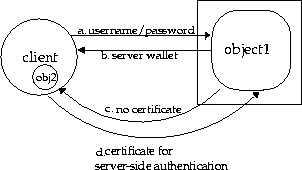

The type of security you can use for callbacks is certificate-based security over SSL. When you add SSL security to callbacks, you can have one of two situations:
  1. Server-side authentication only
    1. The client is not required to authenticate itself with a certificate. However, it must still authenticate itself to the database using a username/password combination.
    2. The server, since server-side authentication is always required with SSL, authenticates itself to the client by providing certificates contained in the database wallet.
    3. When the server calls back to the client, it acts as a client; thus, it is not required to provide certificates for authentication.
    4. The called object, although contained in the client, is the server object in the callback scenario. Thus, since server-side authentication rules hold, the callback object must provide certificates to authenticate itself.
Example 6-2 Callback code with server-side authentication only
The following code shows the client code that performs (a) and (d) steps above. The first half of the client code sets up a username and password for authenticating itself to the database. It retrieves the server object. However, before it invokes the server's method, the last half of the code sets up the client callback object by setting certificates, initializing the BOA, and instantiating the callback object. Finally, the server method is invoked.

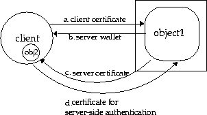

  • Client-side and Server-side authentication
    1. The client is required to authenticate itself with a certificate.
    3. When the server calls back to the client, it acts as a client; thus, it is required to provide its own certificates for authentication.
      The code for the client shown in Example  6-2 is the same for this scenario, except
      that instead of providing a username and password, the client provides certificates.
      Since client-side authentication is required and because the server is acting as a
      client, the server code sets up identifying certificates for itself before invoking the
      callback object. The server must create and send its own certificates, it cannot
      forward on the client's certificates for authentication. You set up your server object
      certificates using either the appropriate JNDI properties or the
      AuroraCertificateManager as discussed in "Using Certificates for Client
      Authentication".
