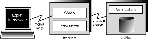

The Oracle8 Connection Manager is a lightweight, highly-scalable program that can receive Net8 packets and re-transmit them to a different server. To a client running Net8, the Connection Manager looks exactly like a database server. An applet that uses the JDBC Thin driver can connect to a Connection Manager running on the Web server host and have the Connection Manager redirect the Net8 packets to an Oracle server running on a different host.
Figure 18-1 illustrates the relationship between the applet, the Oracle8 Connection Manager, and the database.
Using the Oracle8 Connection Manager requires two steps, described immediately below:
There is also discussion of how to connect using multiple connection managers.

This section describes how to write the connect string in your applet so that the applet connects to the Connection Manager, and the Connection Manager connects with the database. In the connect string, you specify an address list that lists the protocol, port, and name of the Web server host on which the Connection Manager is running, followed by the protocol, port, and name of the host on which the database is running.
The following example describes the configuration illustrated in Figure 18-1. The Web server on which the Connection Manager is running is on host webHost and is listening on port 1610. The database to which you want to connect is running on host oraHost, listening on port 1521, and SID ORCL. You write the connect string in TNS keyword-value format:
Connection conn = DriverManager.getConnection ("jdbc:oracle:thin:" + "@(description=(address_list=" + "(address=(protocol=tcp)(host=webHost)(port=1610))" + "(address=(protocol=tcp)(host=oraHost)(port=1521)))" + "(source_route=yes)" + "(connect_data=(sid=orcl)))", "scott", "tiger");
The first element in the address_list entry represents the connection to the Connection Manager. The second element represents the database to which you want to connect. The order in which you list the addresses is important.
Notice that you can also write the same connect string in this format:
String connString = "jdbc:oracle:thin:@(description=(address_list= (address=(protocol=tcp)(port=1610)(host=webHost)) (address=(protocol=tcp)(port=1521)(host=oraHost))) (connect_data=(sid=orcl)) (source_route=yes))"; Connection conn = DriverManager.getConnection(connString, "scott", "tiger");
When your applet uses a connect string such as the one above, it will behave exactly as if it were connected directly to the database on the host oraHost.
