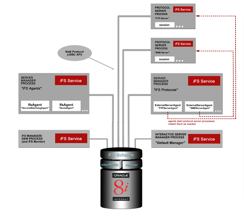

The default installation is configured for three pre-defined servers to run with Server Managers:
In the following diagram, three Server Managers are displayed. The first Server Manager is managing the protocol servers; the second is managing the agents; and the third Server Manager is running interactively, monitoring the servers. In addition, Oracle iFS Manager is running. These Server Managers can be running on either the same or on different machines. All three Server Managers are able to monitor any registered server or agent running in the system.
Figure 8-1 Oracle iFS Server Manager Diagram
Another important tool are the log files. The log files detail the activity on the protocol server. Some servers have the option to output verbose logging. As the administrator, you will need to manage these files because over time, these files can become quite large depending upon the activity and type of logging selected. By default logging will be appended to the current log.

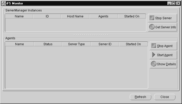

To use Oracle iFS Manager to manage the Server Manager instances, you use Oracle iFS Monitor. Oracle iFS Monitor uses the same Server Manager commands you use on a command line, but through a graphical interface. You still have the option of issuing Server Manager commands on the command line, but now there is an easier way of managing the servers and agents monitored by Server Manager through Oracle iFS Manager.
The Oracle iFS Monitor is only used to monitor the servers and agents started by Server Manager. You cannot use Oracle iFS Monitor to start Server Manager; you must start Server Manager from the machine where Oracle iFS was installed. However, you can use Oracle iFS Monitor to stop the agents and the Server Manager instance that is monitoring the agents.
Oracle iFS Monitor displays the servers registered with the database and the agents managed by Server Manager.

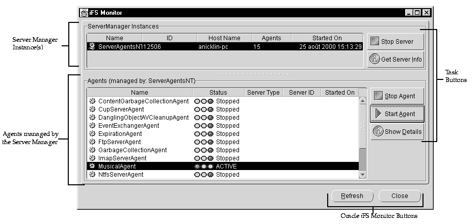

Parts of the Oracle iFS Monitor Window
The Oracle iFS Monitor window has the following parts:
Where:
Task Buttons
The buttons on the right side of the Oracle iFS Monitor window are used to perform Server Manager tasks. The following table describes the buttons and their purpose.
Button  Purpose
Stop Server
Stops the selected Server Manager instance and all protocols.
Get Server Info
Describes the selected Server Manager instance in a separate window.
Stop Agent
Stops a selected agent.
Start Agent
Starts a selected agent.
Show Details
Shows the details of a selected agent in a separate window.

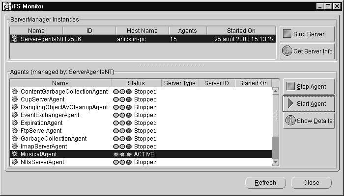

Oracle iFS Monitor is accessed through Oracle iFS Manager by selecting Monitor from the File menu. A window displays containing the Server Manager instances and agents. If you are starting Oracle iFS Monitor before starting an instance of Server Manager, no information is displayed as shown here:
When a Server Manager instance is started, select the Server Manager for which you want to view agents. The agents display in the Agents box as shown here:
All agents are displayed, even if they are have a status of Stopped.
