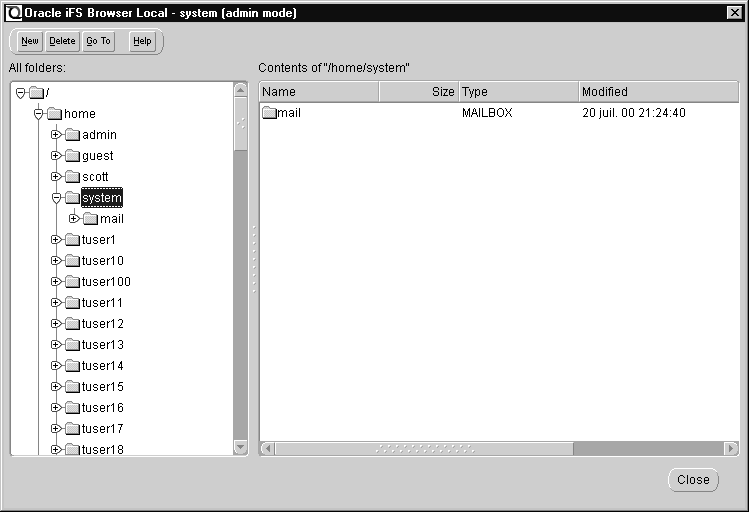

Browser
If you select Browse from the File menu, Oracle iFS Manager displays a window showing the folder hierarchy of the connected Oracle iFS instance. The browser consists of a Navigator and a toolbar that lets you create a new directory, delete a directory, and go to a specific directory. To the right of the Navigator, Oracle iFS Manager displays the attributes of folders as you select them in the Navigator. The Browser provides:
Figure 3-2 Browser

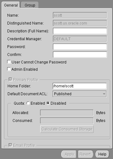

Working with Property Sheets
When an object in the Navigator is selected, one or more property sheets display in the Detail View. Use the property sheet to view details about objects or to modify them. See Figure 3-3 for an illustration of a property sheet.
Figure 3-3 Property Sheets
Modifying Objects Using Property Sheets
The following buttons are used when modifying objects using property sheets:
