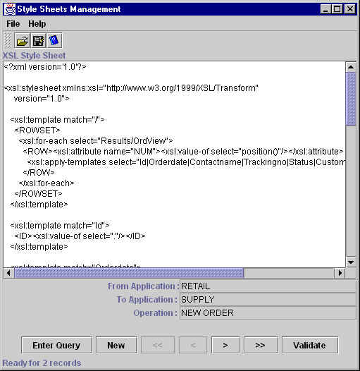

  1. Check the StyleSheet utility to ensure it works by invoking SS.bat.

    Using this utility you can browse the actual table, Stylesheets, in which the stylesheets are stored. These stylesheets are used by the AQ Broker-Transformer to process the documents it received. See Figure 13-7.
Figure 13-7 Checking the StyleSheet Utility

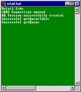

  1. Start the Retailer application by running retailer.bat. See Figure 13-8.
Figure 13-8 Starting the Retailer Application

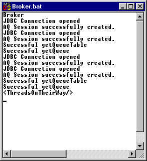

  1. Start the AQ Broker-Transformer application by running broker.bat. See Figure 13-9.
Figure 13-9 Starting the AQ Broker-Transformer Application

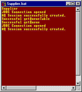

  1. Start the Supplier application by running supplier.bat. See Figure 13-10.
Figure 13-10 Starting the Supplier Application: "Supplier Watcher"

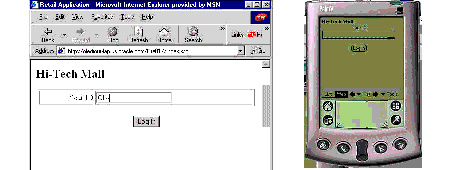

  • [Retailer] Log in. You will see a Welcome! screen. See Figure 13-11.

    Figure 13-11 [Retailer]: Logging in from a Browser or PDA

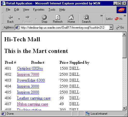

  • [Retailer]: The resulting screen displays the Hi-Tech Mall Catalog product listing. Click on the product you are interested in. See Figure 13-12.

    Figure 13-12 [Retailer] Enter the Hi-Tech Mall (Mart) Catalog

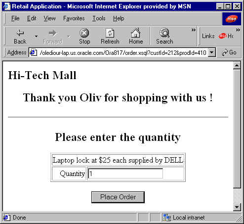

  • [Retailer]: Enter the quantity you need and click the "Place Order" button. See Figure 13-13.
    Figure 13-13 [Retailer]: Enter the Quantity and Click on "Place Order"

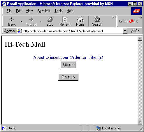

    1. [Retailer] Click "Go On", or "Give Up". See Figure 13-14.

    Figure 13-14 [Retailer}: Click "Go On"
