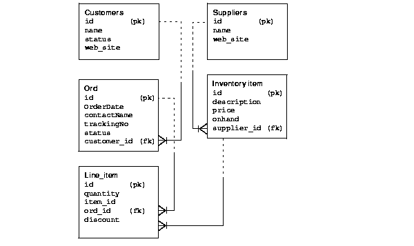

The schemas used in the B2B XML application you are about to build, are illustrated in Figure 13-3.
To run the B2B XML application carry out the following tasks as described:
The details for running the B2B XML application including what you will see on your browser, are provided in "Running the B2B XML Application: Detailed Procedure" . You will also see typical screenshots of what the Retailer and Supplier see.
Figure 13-3 B2B XML Retailer (Customers) and Supplier Schema

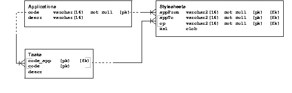

Figure 13-4 B2B XML AQ Broker Schema: Stylesheets

  2. Check the StyleSheet utility by running GUIStylesheet.class
These stylesheets are used by the Broker to process the documents it receives.
