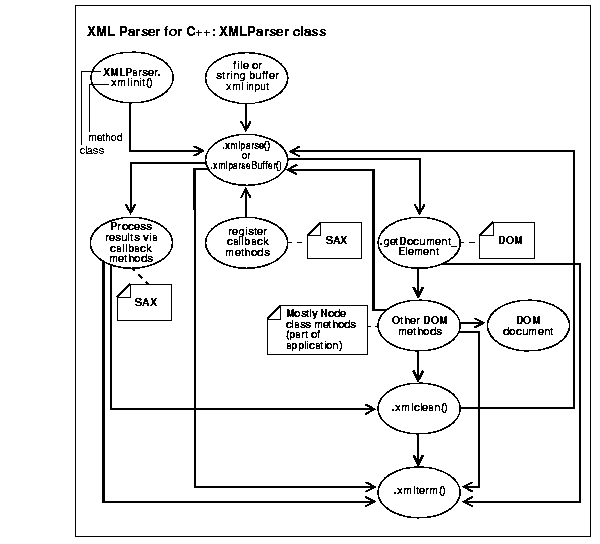

Figure 22-1 illustrates the XML Parser for C++ functionality.
  1. The parsing process begins with the xmlinit() method.
  2. The XML input can be either an XML file or string buffer. This inputs the following methods:
    • XMLParser.xmlparse() if the input is an XML file
    • XMLParser.xmlparseBuffer() if the input is a string buffer
  3. DOM or SAX API
    DOM: If you are using the DOM interface, include the following steps:
    • The XMLParser.xmlparse() or .xmlparserBuffer() method calls .getDocument Element(). If no other DOM methods are being applied, you can invoke .xmlterm().
    • This optionally calls other DOM methods if required. These are typically Node class methods or print methods. It outputs the DOM document.
    • If complete, the process invokes .xmlterm()
    • You can optionally first invoke .xmlclean() to clean up any data structure created during the parse process. You would then call .xmlterm()
    SAX: If you are using the SAX interface, include the following steps:
    • Process the results of the parser from .xmlparse() or .xmlparseBuffer() via callback methods.
    • Register the callback methods
  4. Optionally, use .xmlclean() to clean up the memory and structures used during a parse, and go to Step 5. or return to Step 2.
  5. Terminate the parsing process with .xmlterm()
Parser Calling Sequence
The sequence of calls to the parser can be any of the following:
Figure 22-1 XML Parser for C++ (DOM and SAX Interfaces) Usage
