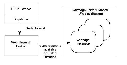

JWeb applications execute within the Oracle Application Server cartridge infrastructure, while Apache JServ 1.1 servlets run with the Oracle HTTP Server and in JVM(s).
In Oracle Application Server, the HTTP listener receives a request for a JWeb cartridge. The listener passes the request to the dispatcher, which communicates with the Web Request Broker (WRB). The WRB uses URL mapping to identify the cartridge instance to which the request should be sent. If no cartridge instances exist for the requested cartridge, the cartridge server factory creates a cartridge server process to instantiate the cartridge. In JWeb, the cartridge server process loads a JVM, which runs a JWeb application (of the Oracle Application Server application paradigm). Figure 2-1 depicts these components graphically.

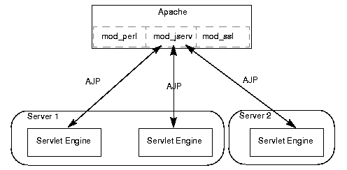

Apache JServ consists of two functional components: mod_jserv and a servlet engine. mod_jserv is an Apache Server module and directs incoming requests for Java Servlets to a servlet engine. The Apache JServ Protocol (AJP) facilitates communication between the two components.
Figure 2-2 illustrates a one-to-many configuration. In a one-to-many configuration, there is one Apache listener and multiple servers. Each server can run one or more servlet engines. In this figure, a single Apache instance is communicating to two servers. Server 1 is running two servlet engines and server 2 is running one servlet engine. Three AJP connections are open between the servlet engines and a single mod_jserv in the Apache instance.
mod_jserv, which is implemented in C, is an Apache module that runs in the same process as the Apache web server. It functions like a dispatcher in that it receives a request from the Apache HTTP listener and routes it to a servlet engine. It does not execute any servlet business logic.

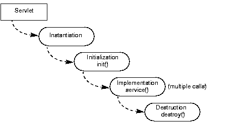

In Apache JServ, Servlet life cycle is compliant with Servlet 2.0 specifications. The life cycle is defined by the javax.servlet.Servlet interface, which is implemented directly or indirectly by all servlets. This interface has methods which are called at specific times by the servlet engine in a particular order during a servlet's lifecycle. The init() and destroy() methods are invoked once per servlet lifetime, while the service() method is called multiple times to execute the Servlet's logic.
Figure 2-3 depicts the servlet life cycle.
