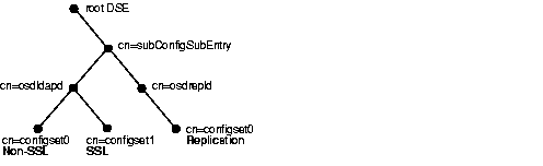

Figure 5-1 shows three separate directory server instances, each with a different value.
Figure 5-1 Directory Entry Hierarchy Showing Multiple Configuration Set Entries
Text Description of oid81017.gif follows
Figure 5-1 shows:

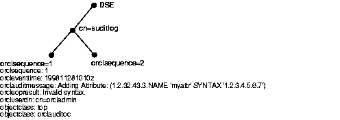

Position of Audit Log Entries in the DIT
The audit log container is part of the DSE. It holds its entries as children, organized according to the orclsequence attribute. See Figure 5-2.
Figure 5-2 Sample Audit Log in DSE
Text Description of oid81018.gif follows

Searching for Audit Log Entries
You can search for audit log entries by using either Oracle Directory Manager or ldapsearch.
Searching for Audit Log Entries by Using Oracle Directory Manager
See:
"Searching for Audit Log Entries by Using Oracle Directory Manager"
Searching for Audit Log Entries by Using ldapsearch
The DN for the audit log container is cn=auditlog. To search for audit log entries, perform a subtree or one-level search, with the container object cn=auditlog as the base of the search.
See:
"ldapsearch Syntax"
