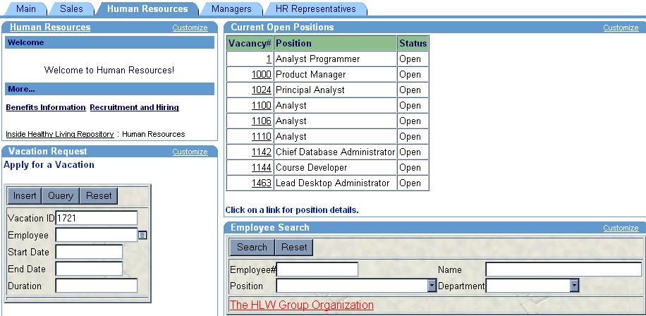

5.1 Create three tabs for your intranet portal
In this section, you will add three tabs to the Inside Healthy Living Human Resources portal that pertain only to the Human Resources department. You will create one each for public users, Managers within the company, and HR Representatives. If you did not follow the steps in Chapter 4, "Creating a line of business page for your intranet portal", you must first create a page called "<YourName> Inside Healthy Living," then add three tabs to the page. For more information on creating pages, refer to Section 3.1, "Create a page".
After you create the tabs, you will specify access privileges for each tab. Any user can view the Human Resources tab, only company managers can view the Managers tab, and only HR representatives can view the HR Representatives tab. This way, when a user logs onto Oracle Portal, only one or two of these tabs will display, depending on the type of user. To implement these access privileges, you need access to the two groups we have provided: HR_MANAGERS and HR_REPRESENTATIVES. If you do not have access to these groups, contact your portal administrator.
Note: All portal administrator tasks are detailed in Appendix A, "Oracle Portal Administrator Tasks".
For more information: Visit the Oracle Portal Online Help. From the Categories list, choose Page Tasks and click Go. In the right pane, click Creating a page.
  1. In Oracle Portal, navigate to the Pages tab.
  2. Click My Pages and find the page called <YourName> Inside Healthy Living.
    Note: You will only see this page if you have followed the steps in Chapter 4, "Creating a line of business page for your intranet portal". If you have not completed Chapter 4, create a page called "<YourName> Inside Healthy Living", then continue with this section. Unlike the illustrations in this chapter, you will not have a Main and Sales page in your portal.
  3. Next to <YourName> Inside Healthy Living, click Edit.
  4. On the Portlets tab, next to the Sales tab, click .
  5. Next to the new tab, click again.
  6. Repeat step 5.
  7. Name the first tab you created Human Resources.
    Note: If you're not sure how to edit the tabs, see Section 4.1, "Create a tabbed page and add a page as a portlet".
  8. Click the Advanced Options tab.
  9. Choose the Specify Access Settings radio button.
  10. Make sure the Display Tab to Public Users check box is selected.
  11. Click Apply.
  12. Click Close.

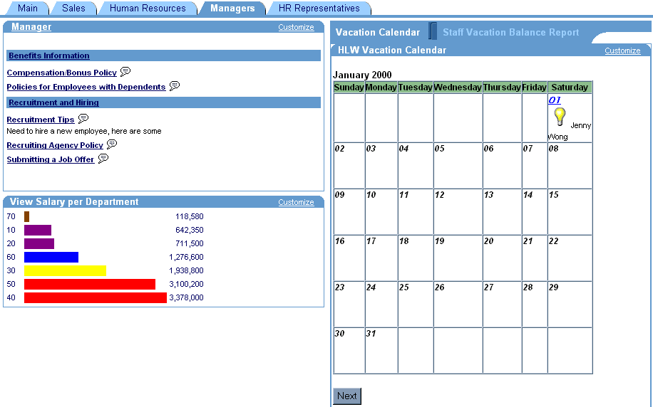

  13. Name second tab Managers.
  14. Click the Advanced Options tab.
  15. Choose the Specify Access Settings radio button.
  16. Make sure the Display Tab to Public Users check box is clear.
  17. In the Grantee field, enter HR_MANAGERS.
    Note: The name you enter here is the group name for the Managers of the Healthy Living Wholesalers company. If you do not see the HR_MANAGERS group, see your portal administrator. Your portal administrator can either import the groups necessary for this chapter, or create them himself. For more information, see Section A.5, "Create three groups for the Human Resources portal" in Appendix A.
  18. From the Privileges list, choose Manage.
    The MANAGE privilege enables all members of the HR_MANAGERS group to modify or delete the page, as well as to grant other groups privileges to the page.
    For more information: Visit the Oracle Portal Online Help. From the Categories list, choose Concepts and click Go. In the right pane, click Who can access a page.
  19. Click Add.
    Note: By granting access to a specific group of users, only members of the specified group can view the page.
  20. Click Finish.
  21. Name the third tab HR Representatives.
  22. Click the Advanced Options tab.
  23. Choose the Specify Access Settings radio button.
  24. Make sure the Display Tab to Public Users check box is clear.
  25. In the Grantee field, enter HR_REPRESENTATIVES.
  26. From the Privileges list, choose Manage.
  27. Click Add.
  28. Click Apply.
  29. Click Close.
  30. Click Finish.
You have now added three more tabs to the Inside Healthy Living portal you created in Chapter 4, "Creating a line of business page for your intranet portal". The Human Resources tab displays to all users who are logged into Oracle Portal; the Managers tab only displays to users who have been added to the HR_Managers group; the HR Representatives tab only displays to users who have been added to the HR_Representatives group.
Note: Your portal administrator can create a user for each group. To test whether your pages display properly for each type of user, contact your portal administrator.
The tabs of the portal should now look something like this:

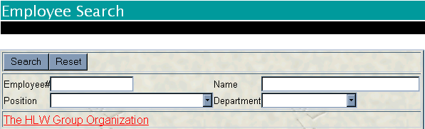

5.2.2 Create an employee search form that links to the team organization chart
The steps in this section show you how to create a form to search for specific employees in the Healthy Living Company. You will also create a link that, when clicked, displays the hierarchy you created in Section 5.2.1, "Create a team organization chart".
  1. In Casebook30_Application, create a form based on a table or view.
    Note: If you do not see this application, contact your portal administrator. The steps in Appendix A, "Oracle Portal Administrator Tasks" assist in obtaining the application we have created for you. For more information on creating a form based on a table or view, see Section 4.6.2, "Create a customer entry form".
  2. Name the form <YourName>_EMPSEARCH and make sure Casebook30_Application is chosen from the Application list.
  3. Base the form on the <DEMO_SCHEMA>.HLW_STAFF table.
    Note: DEMO_SCHEMA is the name of the schema where the demo schema objects are installed.
  4. Choose a Tabular Form layout.
  5. On the Formatting and Validation Options tab, in the left pane, delete the all buttons except:
    • QUERY_TOP
    • RESET_TOP
  6. In the left pane, under TOP_SECTION, delete all columns in the table, except:
    • EMPLOYEE_ID
    • NAME
    • JOB
    • DEPARTMENT_NO
  7. Make the following changes to the Form Level Options:
    • Box Background Color = Wheat
    • Box Background Image = Dude
    • Box Border = Thick Border
    • Order by NAME, Ascending
  8. Change the font, font color, and font size for all fields to:
    • Font Face = Arial
    • Font Color = Black
    • Font Size = 0
  9. Change the label for QUERY_TOP to Search.
  10. Change the label for EMPLOYEE_ID to Employee#.
  11. In the left pane, click JOB.
  12. From the Item Type list, choose Combobox.
  13. In the Label field, enter Position.
  14. From the List of Values list, choose <YourName>_JOB_LIST.
    Note: This is the LOV you created in Section 4.5.3.1, "Create JOB_LIST dynamic list of values". If you did not create this LOV, you can create it now or use HLW_JOBLIST, which we have provided. If you do not see HLW_JOBLIST, contact your portal administrator.
  15. Make sure the Default Value field is empty, and that Default Value Type is No Selection.
  16. In the left pane, click DEPARTMENT_NO.
  17. From the Item Type list, choose Combobox.
  18. In the Label field, enter Department.
  19. From the List of Values list, choose <YourName>_DEPARTMENT_LOV.
    Note: This is the LOV you created in Section 4.5.3.3, "Create DEPARTMENT_LOV static list of values". If you did not create this LOV, use HLW_DEPT_LOV, which we have provided. If you do not see HLW_DEPT_LOV, contact your portal administrator.
  20. Make sure the Default Value field is empty, and that Default Value Type is No Selection.
    Note: If you do not want to link the employee search form to the team organization chart, you can click Finish at this point, then jump to step 32.
  21. Next to FORM, click .
    A dialog displays.
  22. In the Name field, enter Contact Employee.
  23. Click OK.
  24. Make the following changes to the Item Level Options for Contact Employee.
    • Item Type = Label Only
    • Label = The HLW Group Organization
    • Link = <DEMO_SCHEMA>.<YourName>_GROUPLIST.show.
      Note: This URL is for the hierarchy you created in Section 5.2.1, "Create a team organization chart". Oracle Portal home is the URL for Oracle Portal. DEMO SCHEMA is name of the schema we provided to you. See your portal administrator for more information.
    • Font Face = Arial
    • Font Color = Red
    • Font Size = +1
  25. Finish the form and publish it to the portal.
When you run the employee search form with a link to the hierarchy, it should look something like this:

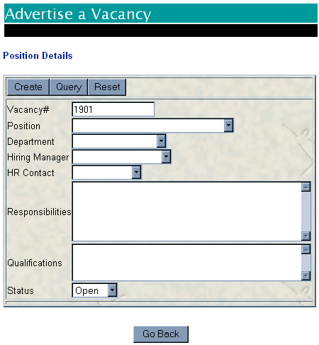

5.3.2.3 Create the form to post or close job vacancies
In this section, you will create a form (which you will later secure so that only HR Representatives can use) that enables a user to post a new job vacancy and update or close an existing one.
    Note: For more information on creating a Form based on a table or view, see Section 5.3.1, "Create a form to look up a specific job vacancy". If you do not have access to Casebook30_Application, contact your portal administrator.
  2. Name the form <YourName>_VACANCYFORM and make sure Casebook30_Application is chosen from the Application list.
  3. Base the form on the <DEMO_SCHEMA>.HLW_VACANCIES table.
  4. On the Formatting and Validation Options tab, delete the REGION_ID field.
  5. Change the following Form Level Options:
  6. In the left pane, click VACANCY_ID and change its label to Vacancy#.
  7. In the Default Value field, enter #<DEMO_SCHEMA>.<YourName>_vacancy_seq.nextval.
    Note: DEMO SCHEMA is the name of the schema that owns the database sequence you created in Section 5.3.2.1, "Create a database sequence for the form".
  8. From the Form Level Validation list, choose isNumber.
  9. Change the label for VACANCY_TITLE to Position.
  10. In the left pane, click DEPARTMENT_NO.
  11. From the Item Type list, choose Combobox.
  12. In the Label field, enter Department.
  13. From the List of Values list, choose <YourName>_DEPARTMENT_LOV.
  14. Make sure the field Default Value is empty and Default Value Type is No Selection.
  15. In the left pane, click HIRING_MANAGER.
  16. From the Item Type list, choose Combobox.
  17. In the Label field, enter Hiring Manager.
  18. From the List of Values list, choose <YourName>_MGRLOV.
    Note: This is the LOV you created in Section 5.3.2.2.1, "Create the Manager dynamic list of values".
  19. From the Set the binding(s) for the bind variable(s) defined in the LOV depno list, choose DEPARTMENT_NO.
    Note: For more information on using bind variable LOVs, see Section 4.5.3, "Create four LOVs for the commission search form".
  20. Make sure the field Default Value is empty and Default Value Type is No Selection.
  21. In the left pane, click HR_CONTACT.
  22. From the Item Type list, choose Combobox.
  23. In the Label field, enter HR Contact.
  24. From the List of Values list, choose <YourName>_HRCONTACTLOV.
    Note: This is the LOV you created in Section 5.3.2.2.2, "Create the HR_CONTACTLOV dynamic list of values".
  25. Make sure the field Default Value is empty and Default Value Type is No Selection.
  26. In the left pane, click VACANCY_STATUS.
  27. From the Item Type list, choose Combobox.
  28. In the Label field, enter Status.
  29. From the List of Values list, choose <YourName>_VACANCYSTATUS.
    Note: This is the LOV you created in Section 5.3.2.2.3, "Create the Vacancy_Status static list of values".
  30. Make sure the field Default Value is empty and Default Value Type is No Selection.
  31. Change the Input Width and Input Height to 1.
  32. In the left pane, delete all buttons except:
    • NEXT
    • PREVIOUS
  33. Change the font face, font color, and font size for all fields to:
    • Font Face = Arial
    • Font Size = 0
  34. On the Form Text tab, in the Display Name field, enter Advertise or Close a Vacancy.
  35. In the Header Text field, enter:
    <b><font face="Arial"><font color="#002299"><font size=+0> Advertise a
    Vacancy
    </font></font></font></b>
  36. In the Footer Text field, enter:
    <div align=center>
    <form>
    <font size=+2>
    <input type=button value="Go Back" onClick="javascript:history.go(-1);">
    Note: This footer text adds a "Back" button to the form so that you can return to the portal after entering information in the form.
  37. Finish the form and publish it to the portal.
When you run the form to post or close job vacancies, it should look something like this:

5.3.4 Create a report that displays all current job vacancies
  1. In Casebook30_Application, create a report from SQL query.
    Note: For more information on creating a report from a SQL query, see the online help.
  2. Name the report <YourName>_VACANCIESREPORT and make sure Casebook30_Application is chosen from the Application list.
  3. On the SQL Query tab, in the SQL Query box, enter:
    select vacancy_id VacID,
           vacancy_title  Position,
           decode (vacancy_status,'O','Open','C','Closed') status
    from   <demo_schema>.hlw_vacancies
    where  vacancy_status = 'O'
    installed.
  4. On the Report Layout tab, choose a Tabular layout.
  5. On the Column Formatting tab, next to VACID, enter Vacancy#.
  6. From the Align list, choose Right.
  7. From the Link list, choose <YourName>_VacancyLink.
    Note: Choose the link you created in Section 5.3.3, "Create a link to connect the vacancy report with the lookup form".
  8. Edit the link.
  9. In the Set Link Parameters dialog, set VACANCY_ID = Null, and choose VACID from the Column Name list.
  10. Click Apply.
  11. Click Close.
  12. Next to Position, make sure the Column Heading Text is Position.
  13. Next to Status, make sure the Column Heading Text is Status.
  14. On the Display Options tab, under Full Page Options, change the options to the following:
    • Type Face = Tahoma
    • Font Size = +0
    • Border - Thin Border
    • Heading Background Color = Green, Pale
    • Table Row Color = White
  15. Follow step 15 to make the same changes to Portlet Options.
  16. Under Row Order Options, next to Order by 1., choose VACID from the list.
  17. On the Report and Customization Form tab, in the Footer Text field, enter:
    <b><font face="Arial"><font color="#002299"><font size=-1> Click on a link
    for position details.</font></font></font></b>
  18. Finish the report and publish it to the portal.
When you run the job vacancies report, it should look something like this:

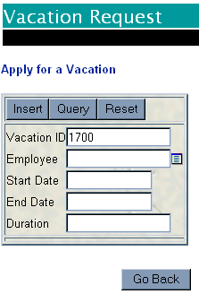

5.4.1.3 Create the Vacation Request form
The steps in this section show you how to create a form where employees can request vacation time.
You will also use the database sequence you used in Section 5.4.1.1, "Create a database sequence for the form".
  1. In Casebook30_Application, create a form based on tables or views.
  2. Name the form <YourName>_VACATION_REQUEST and make sure Casebook30_Application is chosen from the Application list.
  3. Base the form on the <DEMO_SCHEMA>.HLW_VACATIONS table and choose a Tabular layout.
  4. On the Formatting and Validation Options tab, change the following Form Level Options:
    • Order By = VACA_START_DATE
  5. In the left pane, click VACA_ID and change its label to Vacation ID.
  6. In the Default Value field, enter #<DEMO_SCHEMA>.<YourName>_Vacation_Seq.nextval.
    Note: DEMO SCHEMA is the name of the schema where Oracle Portal is installed. <YourName>_Vacation_Seq is the name of the database sequence you created in Section 5.4.1.1, "Create a database sequence for the form".
  7. In the Label field, enter Department Number.
  8. In the left pane, click EMPLOYEE_ID.
  9. From the Item Type list, choose Popup.
  10. In the Label field, enter Employee.
  11. From the List of Values list, choose <YourName>_EMP_LIST.
    Note: This is the LOV you created in Section 5.4.1.2, "Create EMP_LIST LOV".
  12. Change the following item labels:
    • VACA_START_DATE = Start Date
    • VACA_END_DATE = End Date.
    • VACA_LENGTH = Duration.
  13. Change the font, font color, and font size for all fields to:
    • Font Face = Arial
    • Font Size = 0
  14. Under BOTTOM_SECTION, delete all the buttons except:
    • PREVIOUS
    • NEXT
  15. On the Form Text tab, in the Display Name field, enter Vacation Request.
  16. In the Header Text field, enter:
    <b><font face="Arial"><font color="#002299"><font size=+0> Apply for a
    Vacation</font></font></font></b>
  17. In the Footer Text field, enter:
    <div align=center>
    <form>
    <font size=+2>
  18. Finish the form and publish it to the portal.
When you run the vacation request form, it should look something like this:

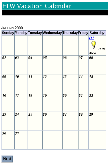

5.4.3 Create a calendar that displays requested vacation dates
The steps in this section show you how to create a calendar that displays the requested vacation time. You will use an embedded link to enable a manager can click on a link in the calendar to display the approval form you created in Section 5.4.1.3, "Create the Vacation Request form".
  1. In Casebook30_Application, create a calendar.
    Note: For more information on creating a calendar, see Section 3.4, "Create an event calendar and add it as a portlet".
  2. Name the calendar <YourName>_VacationCalendar, and make sure Casebook30_Application is chosen from the Application list.
  3. On the SQL Query tab, in the SQL Query field, enter:
    select
        v.vaca_start_date the_date,
        E.name      the_name,
        null               the_date_link,
     '<DEMO_SCHEMA>.wwa_app_module.link?p_arg_names=_moduleid&p_arg_
    values=<REQUEST_FORM_MODULE_ID>&p_arg_names=_sessionid&p_arg_values=&p_arg_
    names=_employee_id_cond&p_arg_values=%3D&p_arg_names=_show_header&p_arg_
    values=YES'||v.employee_ID||' '       the_name_link,
        null               the_target
    from <DEMO_SCHEMA>.hlw_vacations v
        ,<DEMO_SCHEMA>.hlw_staff e
    where e.employee_id = v.employee_id
    order by 1
    Note: Do not copy and paste this SQL code directly into your browser. You must change a few parameters first. REQUEST_FORM_MODULE_ID is the module ID for the Vacation Request form you created in Section 5.4.1, "Create a vacation request form". You can find the module ID by going to the Manage Component dialog for the form, then dragging your mouse over the Run link. The module ID displays in the status bar at the bottom of your browser. DEMO_SCHEMA is the name of the schema that owns Oracle Portal.
  4. On the Display Options tab, in the Link Icon field, enter wgen.gif.
  5. On the Calendar and Customization Form tab, in the Footer Text field, enter:
    <b><font face="Arial><font color="#002299"><font size=-1> My Team's Calendar
  6. Finish the calendar and publish it to the portal.
When you run the calendar that displays requested vacation time, it should look something like this:

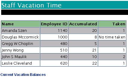

5.4.4 Create a vacation balance report
The steps in this section show you how to create a simple report that displays the remaining vacation balances for all employees. The data in this report changes according to what vacation time has been approved by the manager.
    Note: For more information on creating a report from a SQL query, see Section 5.3.4, "Create a report that displays all current job vacancies".
  2. Name the report <YourName>_VACATION_BALANCE and make sure Casebook30_Application is chosen from the Application list.
    select e.name   name
          ,e.employee_id  empno
          ,e.vacation_days  vacdays
          ,v.vaca_length vaclen
    from  hlw_staff e
          ,hlw_vacations v
  4. On the Report Layout tab, choose Tabular.
  5. On the Column Formatting tab, change the Column Heading Text for the following columns:
    • NAME = Name
    • EMPNO = Employee ID
    • VACDAYS = Accumulated
    • VACLEN = Taken
  6. On the Display Options tab, make the following changes to the Full Page Options and Portlet Options:
    • Font Size = +0
    • Border = Thin Border
    • Table Row Color(s) = White
  7. Make the following changes to the Row Order Options:
    • Order By = NAME
  8. On the Customization Form Display Options tab, in the Display Name field, enter Staff Vacation Time.
  9. In the Footer Text field, enter:
    <b><font face="Arial"><font color="#002299"><font size=-1> Current Vacation
    Balances
  10. Finish the report and publish it to the portal.
When you run the report that displays employees' vacation balances, it should look something like this:

5.6.1 Add portlets to the Human Resources tab
The steps in this section show you how to build the main Human Resources page, which is viewable by the public.
  1. In the Navigator, next to the Inside Healthy Living page, click Edit.
  2. Click the Human Resources tab.
  3. Add a column, then add two rows to the left region, and two rows to the right region.
    Note: If you are not sure how to add columns, rows, or regions to a tab, see Chapter 3, "Creating an intranet portal and adding simple portlets".
  4. In the top left region, add a portlet.
  5. In the Add Portlets dialog, find Healthy Living Repository.
  6. Add the Human Resources folder.
  7. Click OK.
  8. In the bottom left region, add <YourName>_Vacation_Request.
    Note: This is the form you created in Section 5.4.1, "Create a vacation request form".
  9. In the top right region, add <YourName>_VACANCIESREPORT as a portlet.
    Note: This is the report you created in Section 5.3.4, "Create a report that displays all current job vacancies".
  10. In the bottom right region, add <YourName>_Employee_Search as a portlet.
    Note: This is the report you created in Section 5.2.2, "Create an employee search form that links to the team organization chart".
  11. Click Close.
  12. On the Pages tab of the Navigator, click <YourName> Inside Healthy Living to view the portal. Click the Human Resources tab if it's not already highlighted.
The Human Resources tab should look something like this:
5.6.2 Build the Managers tab
The steps in this section show you how to design the Managers tab of the Inside Healthy Living portal.
  1. In the Navigator, next to <YourName> Inside Healthy Living, click Edit.
  2. On the Add Portlets page, click the Managers tab.
  3. Add a column, then add a row to the left region.
  4. In the top left region, add the Manager perspective from the Healthy Living Repository (content area).
    Tip: This portlet is under the Inside Healthy living Repository provider.
  5. In the bottom left region, add the View Salary by Department chart from the Tutorial30 Application.
    Note: If you do not see this chart, contact your portal administrator. Or, you can omit this chart from the tab.
  6. In the right region, create a two-tabbed portlet.
  7. Name the first tab Vacation Calendar.
  8. Name the second tab Staff Vacation Balance Report.
  9. Add <YourName>_Vacation_Calendar to the first tab.
    Note: This is the component you built in Section 5.4.3, "Create a calendar that displays requested vacation dates".
  10. Add <YourName>_Vacation_Balance to the second tab.
    Note: This is the component you built in Section 5.4.4, "Create a vacation balance report".
  11. Click Close.
  12. On the Pages tab of the Navigator, click <YourName> Inside Healthy Living to view the portal. Click the Managers tab if it's not already highlighted.
The Managers tab should look something like this:
