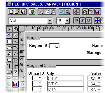

Using the Chart Wizard to add a chart to an application is a 5-step process:
  1. Create a new chart item.
  2. Select a chart title, type and subtype.
  3. Specify the chart's data source.
  4. Specify the chart's X and Y axes.
  5. Specify a filename for the chart file.
When you finish with the wizard, you will have a fully-functional and dynamic chart embedded in your Form Builder application. End users that run the application will see the chart change dynamically when they view different data.
