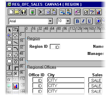

Using the Chart Wizard to add a chart to an application is a 5-step process:
  1. Create a new chart item.
  2. Select a chart title, type and subtype.
  3. Specify the chart's data source.
  4. Specify the chart's X and Y axes.
  5. Specify a filename for the chart file.
When you finish with the wizard, you will have a fully-functional and dynamic chart embedded in your Form Builder application. End users that run the application will see the chart change dynamically when they view different data.
To create a new chart item, click the Chart Item button in the Layout Editor and drag out an area on the canvas where you want to display the chart (the Chart Wizard will appear automatically).
