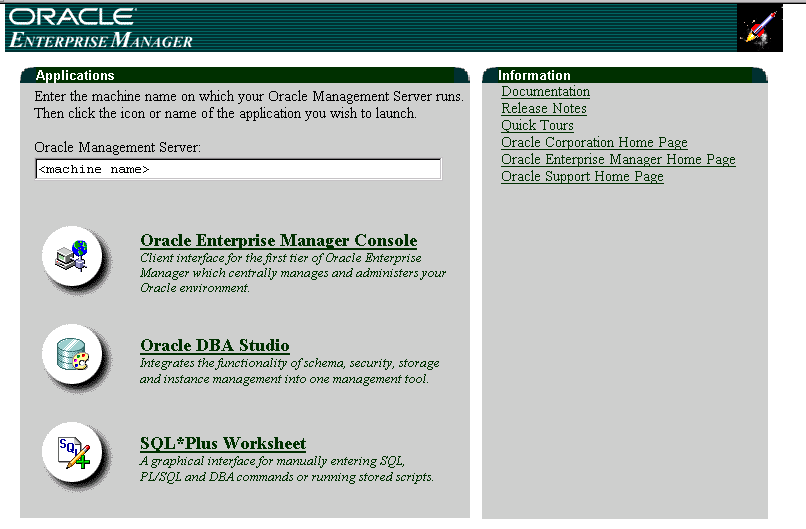

http://<webserver hostname>:<port number>/.
oem_webstage/EMWebSite.html
For example:
http://jfox-sun:3339/oem_webstage/EMWebSite.html
If you are entering the URL for the first time, you must install Oracle JInitiator Release 1.1.7 or higher plug-in.
Once the java plug-in is installed, the Oracle Enterprise Manager Login dialog will appear.
